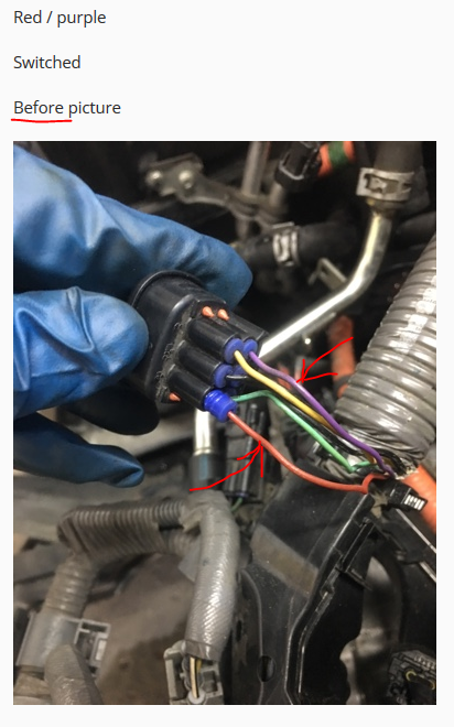

    Could I have actually damaged the new EGR, stepper motor or anything when I switched the red and purple wires like the previous posts had mentioned??

    So apparently it was RightOnTime who supplied that information "some time back" (from January 30th), but who also said recently
    If my eyes don't deceive me, this photo seems to show pins 3 and 4 being swapped, not 1 and 6. Remember that the pinout drawing shown above is as seen by a person looking at the valve.
    So EGR1 and EGR2 were getting swapped.
    Mendel posted excerpts from both Repair Manuals over here, and they both show the same pinout of 1:EGR4, 2:+B1, 3:EGR2, 4:EGR1, 5:+B2, 6:EGR3.
    In that post, apparently Dave Hanson is crediting Sandog58 with having "figured it out".
    Sandog58 isn't mentioned anywhere on PriusChat but that one thread, and maybe isn't a member.
    The 2010 manual does have this sequencing info:
    This is at idle, so that apparently is the sequence you use to drive the valve in the closing direction: EGR4 EGR3 EGR2 EGR1 EGR4 EGR3 EGR2 EGR1 and so on.
    (Funny, I had always pictured the ECM trying to learn where 'closed' is and then stop sending signals, but if they're saying you can scope this pattern any time you're idling with a warm engine, then the strategy must be whenever the engine is idling, the ECM is just constantly whispering to the valve ... psst ... close ... close close close ... close close close close .... Sure, that would work without having to learn much. Then when you're driving under load and it wants some EGR, it's pretty sure 'closed' is where it's starting, and can count up the right number of steps.)
    So swapping the top two waveforms looks at first glance as if it would just kind of trap the rotor wobbling back and forth between two steps. But the reality is even funnier. The diagram up in #344 shows the motor is made with two distinct center-tapped windings, fed with battery voltage at their middles: EGR1 and EGR3 are the two ends of one, with EGR2 and EGR4 being the two ends of the other.
    Swapping EGR1 with EGR2 changes their allegiance. Now what you've got is two center-tapped windings, each of which is half the time completely off (not grounded at either end), and the other half the time pulling in both directions at once!
    Oh, to ask Sandog58 where the idea came from.
    Could it be as simple as, Toyota switched the wire colors for EGR1 and EGR2 between years, and Sandog58 assumed that meant the circuits had to be swapped?
    Or was it just dreamed up as a way to do an "EGR delete" that the ECM wouldn't immediately catch on to with a P0403?

    Hum! @RightOnTime, it looks like you've got a valve of each kind there (post 337). Or were those just the two Gen 3 versions (-37110 and -37120)?
    Looks like Gen 4 are -37140 or even later -37150.
    It should be easy to see if something has changed in the pinout. The Gen 3 valve has the two separate center-tapped windings on the two rows of pins in the obvious way: pin 2 is the center tap between pin 1 and pin 3, and pin 5 is the center tap between pin 4 and pin 6. An ohmmeter should see about 20 Ω from pin 2 to 1 or 2 to 3, and from pin 5 to 4 or 5 to 6, but there should be no continuity between any of the bottom row pins and any of the top row pins.
    If that somehow changed with the newer valve, that could explain the repinning.
    But wait ... that test procedure is still in the Gen 4 manual bit that Mendel posted:
    ... and with no differences.
    @Sandog53 reported having "tested the wires with a multimeter" ... it would be great to know what was tested, and what conclusions that led to.

    Dave henson did you swap EGR wires because you were having problems or just because sand dog did it?

    We confirmed the EGR pinout is the same with Both Gen 3 and Gen 4.
    No need to worry
    michaud85 likes this.
