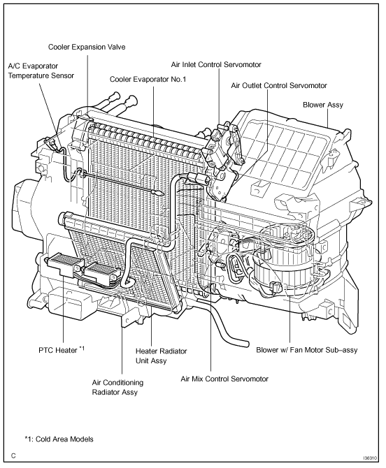

    So, is the area where the evap cleaner needs to be sprayed approx right in front of where the passenger would sit? I see 2 lines going thru the firewall right there. It looks like if the relay box is loosened that it would not be too digfficult to cut the rubber grommet and get at that area with a long tube. Where does the stuff you spray on the coil drip to? My car stinks like a sewer too and i need to remidy it soon.

    I'm already at my hobby farm and took the FJ. If I recall, the e-coil tubing enters about the centre of the firewall, so not directly in front of the passenger. I think the lines you see are the heater core lines
    After looking it over again, I would no longer recommend drilling into the case. I had some pretty exotic tools - eg fibre optic inspection scope - to see where I was drilling into.
    It's easier to cut the rubber grommet where the A/C lines enter through the firewall, as the e-coil is up against the inside of the firewall. You can then spray the disinfectant directly onto the e-coil
    Forum member Hobbit has posted many detailed instructions and photos of how to easily remove the cowl to clean out the cowl area, also a potential source of smell. With the cowl off, it's *very* easy to access the A/C lines and the grommet on the firewall
    The EvapFresh will both disinfect and clean the e-coil. The excess will drain the same way the condensation does, out the drip tube. NuCalgon does not recommend rinsing the coil after applying EvapFresh
    I'm going to attach the diagram again. The orientation is from the passenger seat, looking towards the front of the car

    You are a brave one. Be careful not to scrape against the fins on the evap coil - they bend easily and will reduce your airflow if you bend them closed by accident. I am not even really sure how this will work for you, but admire your courage to try.
    Jayman- thanks much for the HVAC layout graphic. I can see from it that running the heater coil is NOT going to be a very effective method of mold control. based on the illustration, the heater coil is in FRONT of the EVAP coil at a slight angle and is much smaller, so that even when fully heated, it may not be effective at killing any mold unless it only resided near the bottom front portion of the evap coil, if that makes sense. you can get a feel for the airflow from the graphic by noticing where the temp sensor is located, which is downstream of the air flow and above the heater coil.

    This is one schematic of the HVAC system
    This is an exploded view
    It's a good question. Going through the center vents, you may just soak the heater core, as it's downstream of the evaporator coil
