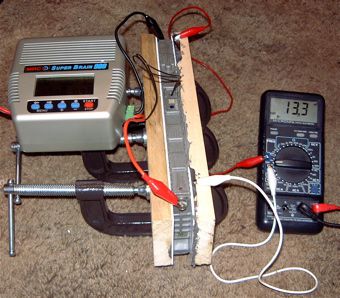

    This is an example:
    The safest approach is to get a computer controlled, RC battery charger. This one has a temperature probe, upper and lower voltage limits, and current control. It also handles charge/discharge cycles and records the capacity. These mean it can handle NiMH charge/discharge cycles without risk.

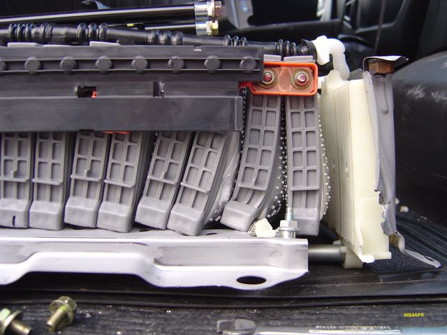

    This is what can happen if a manual process is used and someone gets distracted:
    The cells overcharged and bulged out fracturing the compression rods.

    "RC battery charger NiMH" turns up a bunch. I found at least 4-6 acceptable chargers on eBay ranging from $17-$50. Read the manuals and pick one that 'makes sense' to you.
    In my case, an MRC 989 worked perfectly. However, other have been used and threads posted with their results.
