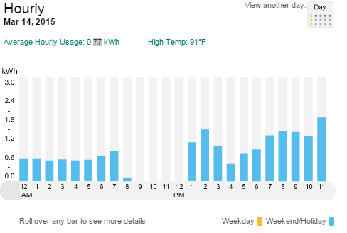

    I have never looked on line - and don't even know if SCE provides such a comprehensive breakdown, but I will look, when I get a chance. The only thing I've studied is the monthly paper bill which shows the entire month as a break even month - or a month where we generate more than we use, or a month where we use more grid power than we generate ... the latter 2 scenarios are then illustrated as average daily surplus or average daily drawn from the grid - like so;
    You can tell we run a lot of Christmas lights during the 3 shortest months of the year
