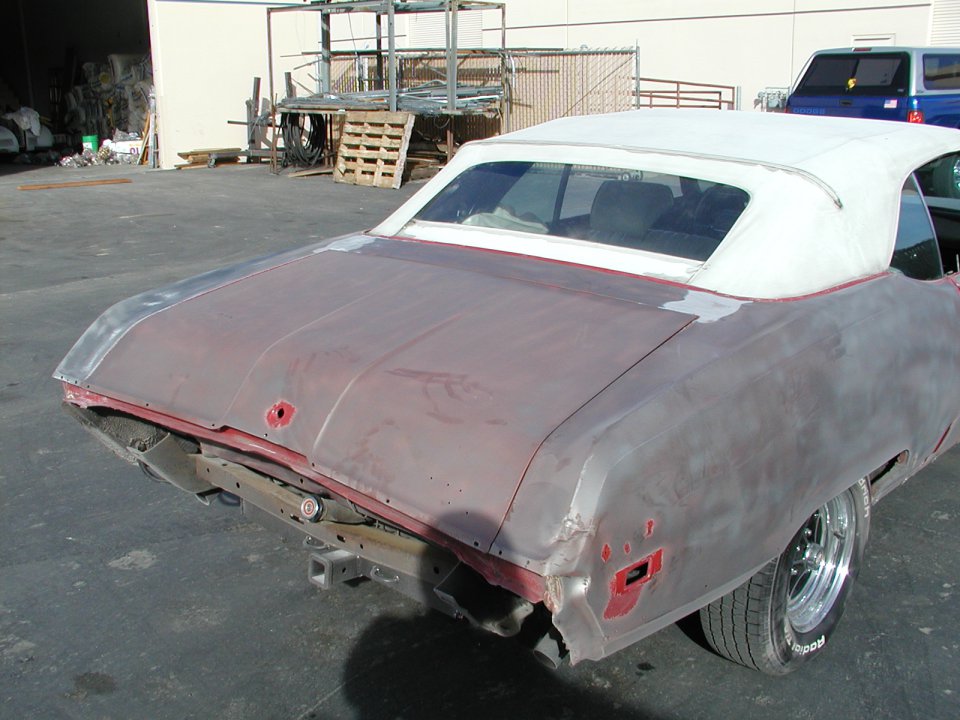

    On our 69 Skylark, the seams just below the rear windshield, at each upper corner of the 1/4 panel, (see the photo below, it is the white area's that are lead), seem to be a weak / flex point on the body. Those 1/4 panel seams were originally lead filled, and they were cracked from flexing, before we began towing a trailer, or restoration. When we restored the Skylark, I had it bead blasted down to bare metal, the lead was obvious on those seams. The body shop told me they did not do lead anymore, so I am sure it got bondo of some sort. We have a hair line crack forming on the drivers side on that seam now, so do pay particular attention to that seam on your car, not having a usual frame might make it even more vulnerable to cracking. Of coarse,, we did not help matters as we sold that smaller tent trailer, and bought a BIG ONE, so towing it around with a welded on hitch, may have potentially contributed to more of that body flex.
