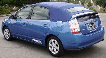

  8. hill
    21,221
    8,810
    Oh yeah, this is the one I was thinking of;
    Not too shabby ....
    PLSPUSH and Bill the Engineer like this.
