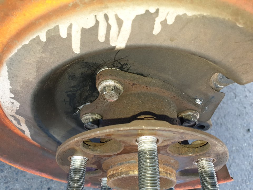

    This is how I measure the toes of the rear wheels. The car is parked as level as possible. At the place where the height of the rear tires is the same, use a tape measure to measure the distance between the fixed patterns of the tires. The different lengths will be obtained. If the rear distance is r , The front distance is f, then f-r= toe. This measurement cannot be measured at the diameter position, only the approximate toe can be obtained. If you want to estimate accurately, you need to use functions such as sin cos tan to calculate. I think if the toe is 0, then at different heights The measurement should all be 0.
    When I tested the resistance, the speed was not high. I was not sure that the thin water on the road would produce sensible resistance, and the wind resistance would be weakened due to the reduced speed. I think the influence of the toes would be greater than the resistance of the water.

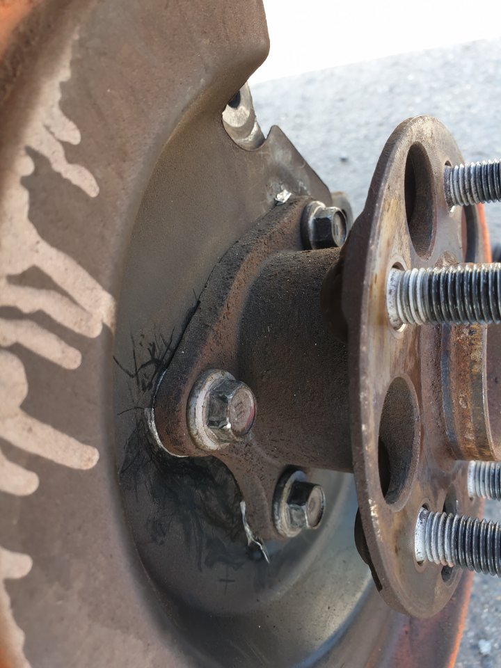

    My back toe is corrected with gaskets, which are processed with aluminum. There are no finished modified parts sold locally. I added a piece on the front top of the bearing plate. The purpose is to change the inclination and toe angle at the same time, and the temperature of aluminum is stretched. The rate is greater than that of steel, and there are 4 screws in total. I only raise the position of one screw. It may also cause uneven force on the bearing plate and produce complex deformations related to temperature. I am not sure about this. Maybe there are other ways to do it. Change the rear wheel toe angle, such as rear torsion beam correction, but that seems to require special tools, I am not sure.

    Hi James- your car sounds like a labor of love!
    Any chance you can attach some photos of this mod to the rear suspension?

    ok bro,When I adjust next time, I will take some pictures.

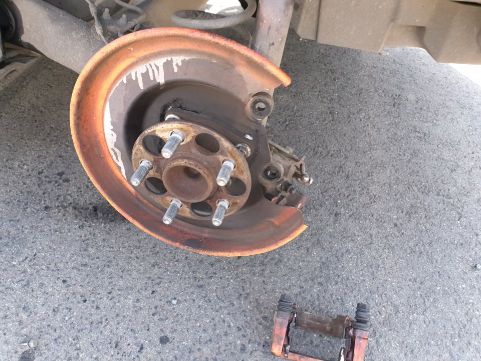

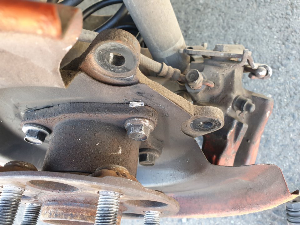

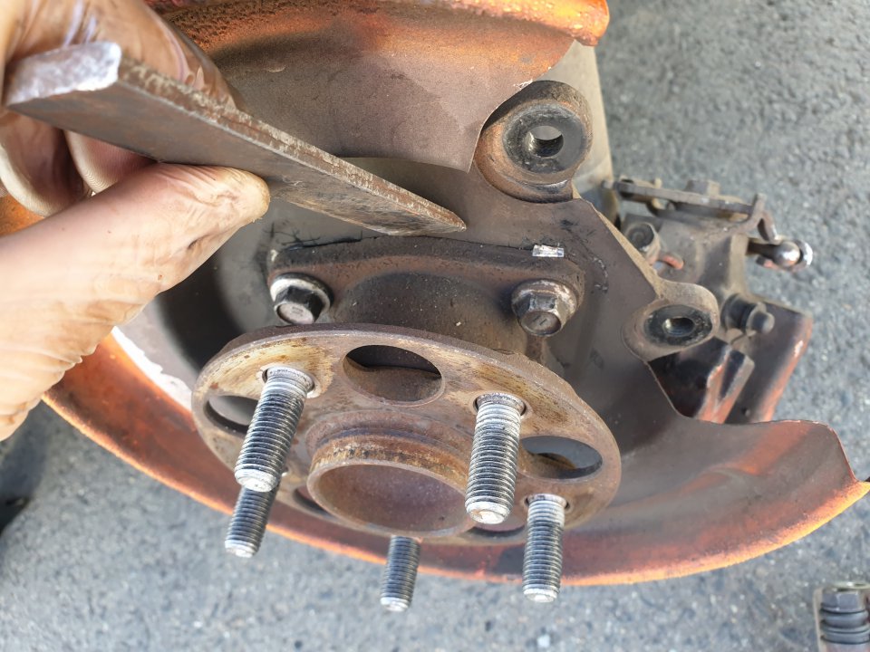

    This is the photo of me adding spacers. The work is not perfect. Limited by materials and tools, it is good to achieve the purpose. The bearing discs of some cars may not be easy to remove. I made tools and used angle grinders to make them easily. It turned out that there was only a spacer in the front-up direction. Today, in order to take a picture, I added very thin spacers in the front-down direction and the back-up direction after disassembling. I hope that the bearing plate's fixed plane will be more evenly stressed.
