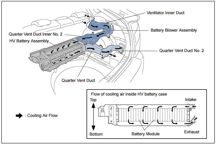

    I think you would be surprised and not in a good way by the effect of that. If you take another, closer look at the way the battery is built, you will notice some things about the way the modules are built (with metallic sides for heat exchange and dimples to ensure thin gaps between modules) and the way the bottom stamping of the battery case is shaped (deeper at the fan end, getting shallower toward the far end of the battery).
    An illustration of airflow from Gen 2 is a good way to see what's going on:
    Because that's a Gen 2 illustration, the airflow's not quite the same: the Gen 2 fan blows into the top of the case, passes downward between all the modules, collecting in the bottom valley of the case and exiting from there.
    Your Gen 3 fan blows into the bottom valley, the air rises between all of the modules, collecting in the top of the case and exiting from there.
    The way the bottom valley grows shallower as it goes farther from the fan serves, as in any well-designed duct system, to keep the air static pressure more or less even across all the intermodule gaps even though the air flowing in the bottom valley decreases by 1/27th with each gap it passes.
    So it turns out those dimples on the module sides really are put there on purpose to create airflow spaces between all of the modules. Restricting those spaces with thermal grease would not be likely to improve matters.

    I guess I didn't look hard enough lol. those diagrams are exactly the things I was looking for. Had I seen them I wouldn't have made this post...
    Looking at that gen 2 diagram makes me think though, why does the gen 2 battery vent outside directly but the gen 3 just dumps it into the spare tire cavity? Is there some exhaust port I'm not seeing?

    Gen 3 has the same air exit locations, out the sides concealed by the bumper cover. You can see one behind the 12 volt battery, and the other if you take out the small tray on the opposite side.
    Gen 3 doesn't have a battery cooling duct that runs all the way to that exit the way Gen 1 and Gen 2 did, but for the air discharged into that space under the cargo box, that's still where it's going to find its way out.
