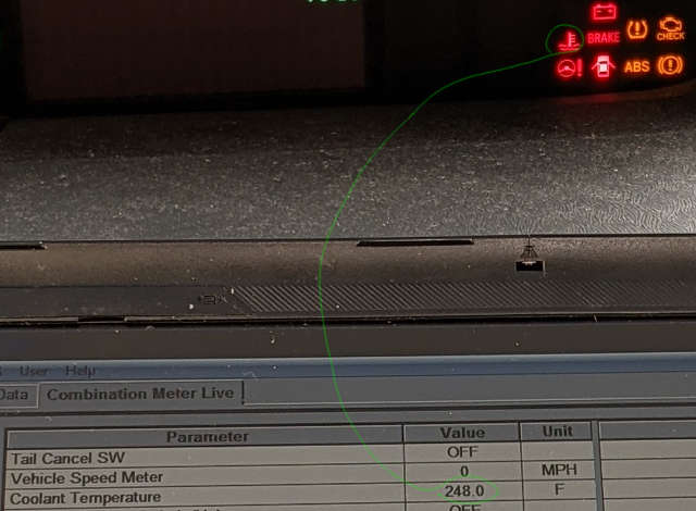

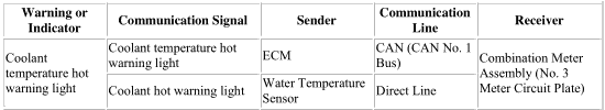

    Gen 3 has two coolant temperature sensors, one in the cylinder head and wired to the ECM, one in the hose returning from the exhaust heat recovery system and wired straight to the combination meter.
    Either one can make the red-thermometer light come on:
    The one in the hose will make the light come on at 120 ℃ (248 ℉).
    I haven't checked at what temperature ECM will make the light come on, based on the sensor in the cylinder head. I wouldn't be surprised if that's the same threshold, 120 ℃, but I haven't seen anyone actually check that the way I did with the other sensor.
    Note that if the ECM has given a code for a water pump problem, it has a lower alarm point, where it will flat-out stop the engine at 105 ℃. The car remains powered up and can do electric driving (for the usual short distance and limited speed). You don't see a temperature light then (because this temperature is lower than where that light comes on); you'll just see the warning triangle and wonder why you have only EV driving. (Ok, you won't really wonder, because you will have had the check-engine light ever since the pump problem was discovered, and if you had read the codes then you would have known it was a water pump problem, and you would have taken care of it.) Moral: don't procrastinate when you see a water pump code.
