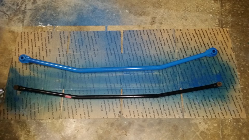

    Thanks for the help. I too struggled breaking the 2 nuts and bolts loose. Solution was to get them hot with a torch. After install my bar was clanking around bad. Had to get larger bolts from the dealer to hold the bar better.
    Bolt 90105-14155
    Nut 90178-14009
