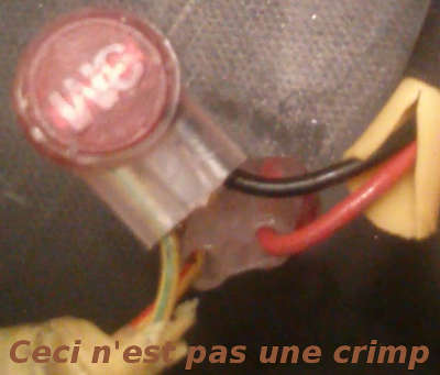

    One place I would snake one is up through the little flaps where the cruise control stalk sticks out of the steering wheel, to get a glimpse inside there behind the airbag. to see if anything looks like this.
