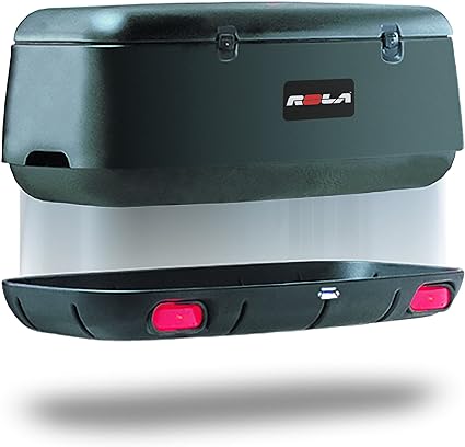

    I have one that works great for my Lexus LX. I got it on Craigslist for 200.00!
    I have never used the ROLA 59109, but it has the swing away feature and you can take the box off and just have the tray if needed. 2" hitch and I don't know how much weight it would "create" on the receiver when it is swung out when loaded.
