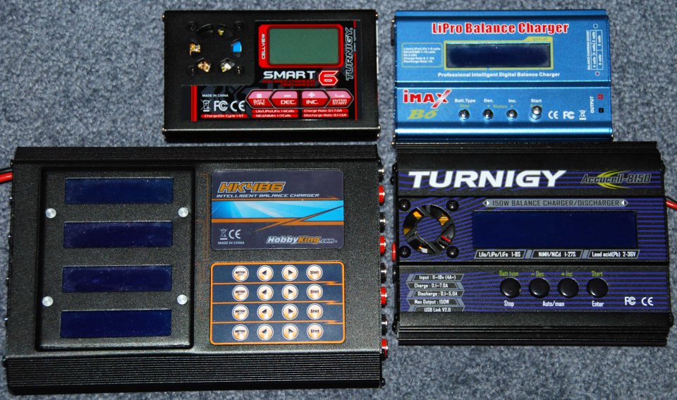

  5. kiwi
    kiwi Member
    Jul 12, 2012
    246
    87
    New Zealand
    Here are some test results of RC Balance Chargers:
    Voltage measurements at Battery terminals were also controlled by Digitech Multimeter (accuracy in 4-40VDC range 1.2% according to manual)
    Voltage measurements observed on Digitech multimeter were in-line with 14-Ch Analyser voltage readings but different from all RC charger’s readings.
    Room Temperature was 21 Celcius (69.8F).
    RC Balance Chargers - here is the summary of CHRG/DSCH test on 4 devices (see photo):
    Voltage readings
    - Charge Mode - higher then alternatively measured by 5.8% – 6.5%
    - Discharge Mode - lower then alternatively measured by 5.5% – 7.3% (one of the tests on ImaxB6 stopped when RC Charger showed 0.93V when it ws 1.10V measured by Digitech and Analyser)
    Current readings
    - Charge Mode - lower then alternatively measured by 5% – 13%
    - Discharge Mode - higher then alternatively measured by 7.5%– 8.7%
    Capacity readings
    - Charge Mode - lower then alternatively measured by 7.3%– 10%
    - Discharge Mode - higher then alternatively measured by 9.6% – 10%
    Nothing better could be expected from those.
