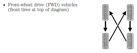

    Hmm - From my daughter's 2011 Ford Fiesta manual:

    Early radials needed Front to back only to prevent damage. (40 years ago) Toyota still seems to prefer it.

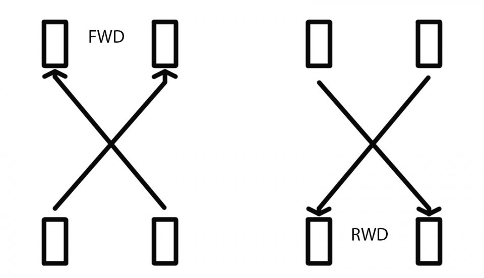

  17. Mendel Leisk
    60,928
    41,926
    Coming from a long line of Hondas, for decades they've recommended front to back and cross to front, with radials. I did that, no ill effects. With the Prius Toyota says front to back and back to front (no cross over), so I do that. Actually, our snows are directional, so it's sort of a moot point, at least with them.
    Either method will work nowadays, I think. FWIW the tire manufacturers, Michelin for one, recommend cross over method with their radials. I think when radials were first introduced there were problems, or expected problems, but over time opinion has shifted, cross over is fine.
