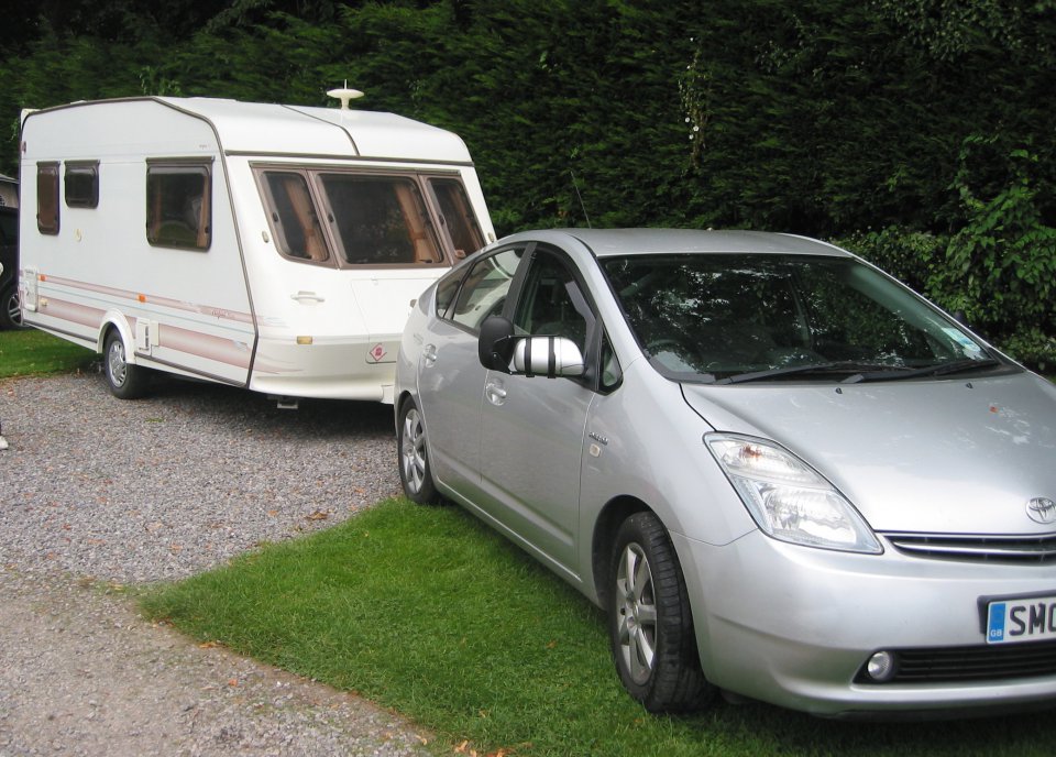

    I regularly tow a caravan at around 2240 lbs without problems, but the maximum gross weight for the van is actually 2360 lbs . This van also has a large frontal area "wind resistance". I tow at sensible speeds "maximum 50 mph on normal roads 60 mph on motorways" and have climbed hills up to 1 in 5 (20%). Fuel consumption has averaged at 49 mpg UK gallons. I tow with a hitch weight of 130 lbs.
    The car is a 2008 at 110,000 miles, and the outfit is shown below.
    While certainly not the best tow car I have driven in the last 50 years, it is by no means the worst.
    John (Britprius)

    The same as the US zero. I do not know the regulations in the US as far as brakes are concerned as some comments have been made that braking when towing is very poor. In the UK if a trailer is over a given weight it must have it's own braking system. In the case of the caravan that I tow the caravan brakes stop the car better when towing than when the car is solo.
