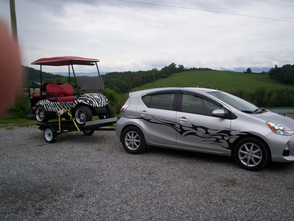

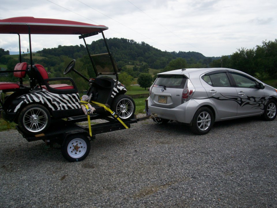

    Golf Cart Towing 04.JPG I have began using my C for towing. I installed the Curt hitch (very easy and well made) and wired up lights. I am towing a very light trailer that I made with a golf cart on it. The whole thing weighs about 1000 lbs. I made it so that I can move location of wheels to put more or less weight on the tongue. Currently I have about 85 lb. on it. This seems about right. I have towed it on city streets and interstate at 65 mph. My gas mileage has averaged 30 mpg when towing and I have had no problems at all. Of course handling and braking are affected but I have a lot of experience with towing so I know how to allow for that. Pictures are enclosed

    Brilliant! This is why I don't buy used cars!

    Awesome! I think you have the record. I'm about to pull 1200lbs soon!
    Do you have a Scan Gauge?
