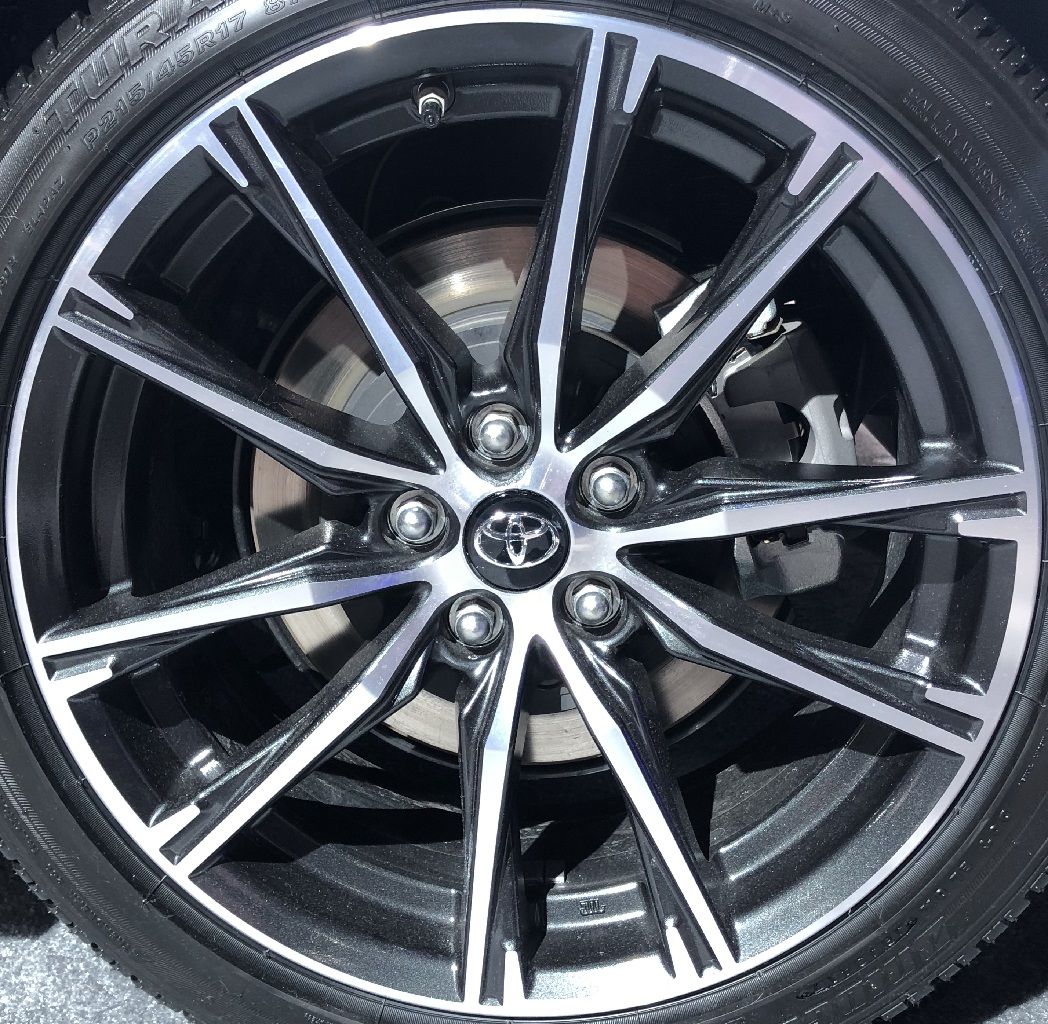

    I have been searching hundreds of post for a few days and I haven't been able to determine what thickness of wheel spacer / adapter I would need to move the newer style 2017, 2018 Toyota 86 17" rims (like pictured / attached) to be flush or even with the fenders, front and back.
    I know that they require a minimum of 3mm not to hit the brake caliper but how wide do they need to be to move the rim out even with the fenders? I understand that going beyond 3mm might/will require longer wheel studs. Any info and pictures would be appreciated. Thanks in advanced.

    I run OZ Ultraleggera 17x8 +48 w/ 25mm spacers on all 4 Corners to "Flush" my wheels, Hope that can shed some light.
