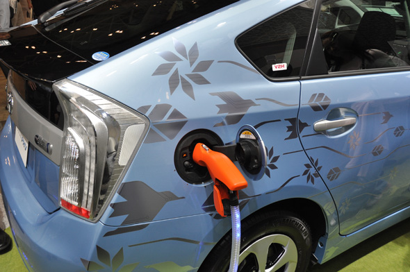

    It's not news that prius is capable of providing power during utility outage.
    Draw current from the 8.8kw to supply appliance for emergency use is very practical.
    This accessory from Toyota seems will do the job without modifying.
    One end plug in to prime's J1772, the other end can supply 120V.
    But does this accessory work with any prime?

  4. Trollbait
    23,744
    12,832
    It is a Japan only accessory, and from promo pictures, it is intended for powering your teapot on picnics.
    Home emergency power from the car is done by a specialized EVSE in Japan. It requires the car to have a CHAdeMO outlet.

    I think the one in the op plugs into the J1772 outlet. I don't think it can supply more than what a small inverter could do.
    The second port on the Prime is for CHAdeMO, and that is needed to have the car supply power to the whole home in Japan. There you can get an EVSE/power station that charges the car through the CHAdeMO outlet, and acts as the inverter for supplying power to the home during an outage.

    Found a webpage from toyota.jp.
    It plugs into J1772 rated 1.5kW at 100V.
    translated by google:
    A: Vehicle power connector
    B: Vehicle power connector (outlet section)
    C: Accessory receptacle (left side of luggage space)
    D: Accessory receptacle (Front console rear end)
    E: Accessory outlet (Front console rear end · Solar charging system installed)

  13. Tideland Prius
    45,459
    16,683
    Electricity in Japan
    Well apparently as long as you're not using a kettle/tea pot or a hair dryer, you might be able to import this accessory and use it in North America.

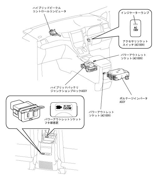

    Turns out the orange adapter already received AC 100V. The inverter is inside the car.
    一方プリウスPHV向けのヴィークルパワーコネクタはインバータを内蔵していない。インバータをプリウスPHVが内蔵しているためだ。図3にあるオレンジ色のアダプタだけで済むので、小型軽量だ。
    On the other hand, the vehicle power connector for Prius PHV does not have an inverter built in. This is because the Inverter is built in the Prius PHV. It's compact and lightweight as it requires only the orange adapter in Figure 3.
    The AC 100V 1500W inverter seems to be under driver seat.
    This is for gen3. not sure how it's now with Prime.

    This is how it is done with the Prius PHV (Prime) in Japan:
    When the newly added EV Power Supply Mode has been selected, the vehicle's external electrical power supply function can supply household electricity without the engine being turned on. In addition, when the HV Power Supply Mode has been selected, the Prius PHV (with the engine running) can supply electricity for about two days at a maximum output level of 1,500W, when starting with a full tank of gasoline. The Prius PHV thus helps to support Toyota's disaster recovery support activities. For example, vehicles equipped with the external power supply function can be introduced into company fleets and loaned out following disasters.
    Toyota Launches Redesigned "Prius PHV" in Japan | TOYOTA Global Newsroom
    This is not for "just boiling a kettle"

    As long as you read the power adapter and it says it's for use as low as 100V, it should be fine, right? I'm guessing most are lower powered devices (like the phone chargers) rather than something like a kettle.
    Well there are several built-in AC100V/1500W outlets in the car (one in the boot, one in the rear console if equipped with the solar roof option and one between the front seats).
    This thread is referring to the accessory that plugs into the J1772 outlet. That is for camping purposes.
