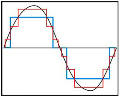

    Crazier: you might be looking at the red waveform in that picture, but the typical "modified sine" inverter produces the blue one. It only switches between three levels: zero, +peak, zero again, −peak.
    It's cheap to build that inverter because it doesn't need to produce any intermediate voltage levels. It only switches off and on (with two polarities).
    If not for the time it spends sitting at zero between humps, it would be a true square wave.
    With any wave, there's more than one way you can measure it. For example, you can measure its peak height. Or you can measure its RMS value, telling you what DC voltage would do the same amount of work.
    For a true sine wave, the peak reading is the RMS reading times √2. So North American household outlets give you 60-cycle AC at 120 volts RMS, same as 170 volts peak. That's nominal, anyway: both the RMS and the peak voltages are given certain allowable ranges.
    Different wave shapes have different relationships between RMS and peak. The game a "modified sine" inverter has to play is to find a shape (by picking the right length of time to sit at zero between the humps) such that both its RMS and its peak values will squeak by in their allowable ranges (the high end of one range and the low end of the other). This StackExchange answer goes into how that's done:
    https://electronics.stackexchange.com/a/625091
    Now, if you've got a regular waveform that isn't a sine wave, Fourier expansion tells us it's mathematically ... a bunch of different sine waves added together. Waveforms with sharp corners, especially, are lots and lots of different sine waves. Of course, that isn't how the inverter produces it (it's just turning switches on and off), but that's what it's producing, anyway.
    If the goal is to just imitate one sine wave at 60 Hz, the "total harmonic distortion" just tells you how much of the output is in waves other than the one you want. For "modified sine" it's around 35%. That is, you think this inverter is giving you 120 volts of 60 Hz AC, but 35% of its output is on frequencies like 180 Hz, 300 Hz, and other higher ones, not 60 Hz at all.

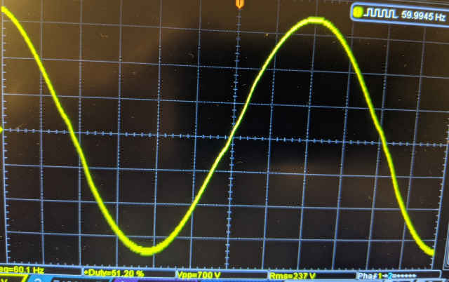

    A true sine inverter does even less - it only switches between + and - (no zero). It just does it way faster using pulse-width-modulation. It looks like this:
    The big reason a true sine inverter is more expensive is that it has to turn that square wave into that sign wave using a *filter*. That filter is usually composed of L's and C's (inductors and capacitors) and those can actually be quite expensive.

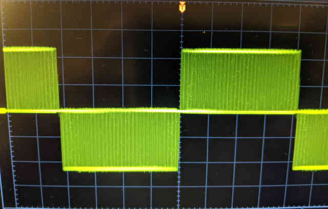

    There are some choices in how it does the switching. Switching losses can be held down by holding one side of the H-bridge on through an entire half cycle and just diddling the other one off and on a bunch of times, then doing the same with the other transistor pair for the next half cycle.
    So the switching really is between + and zero (a bunch of times) and then between − and zero (a bunch more times).
    All those little kicks keep a current rolling through the big inductor, like this:

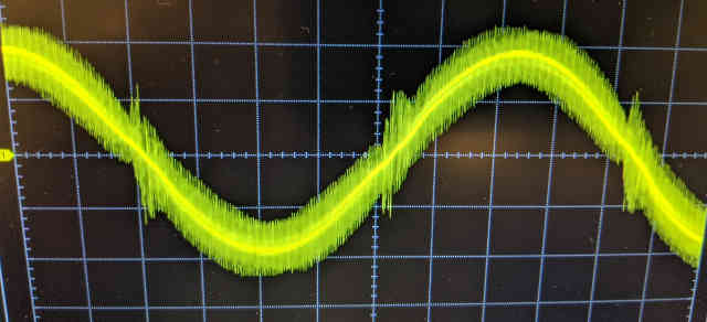

    ... and after filtering the output:
    Those pics (and more details) are in this thread:
    My install and review of the ConVerdant LFI30-220 3kVA Pure Sine Wave Inverter for Backup Power | PriusChat
  20. Lee Jay
    Lee Jay Senior Member
    Jun 25, 2009
    5,850
    4,036
    Westminster, Colorado
    Yeah, if it's a 3-level system, or a 2-level system in a 3-phase configuration you will have a zero. In these cheap single-phase systems, that's not common.
