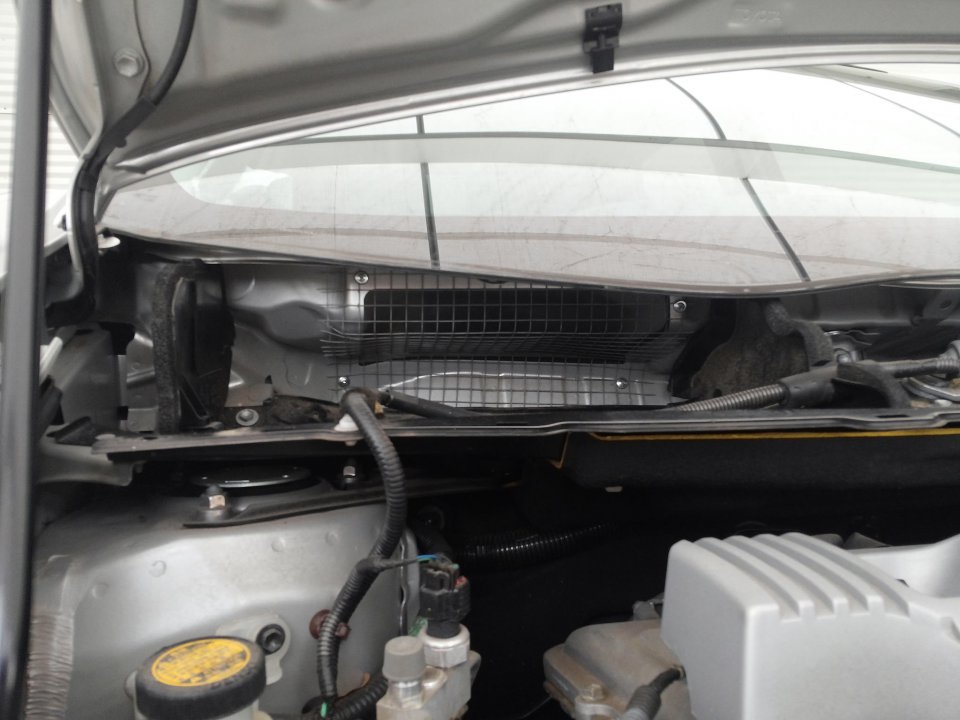

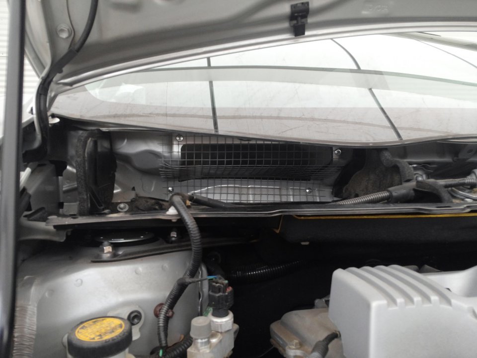

    On the models we own, removing the grill and/or cowling at the windshield wipers and afixing an appropriately shaped piece of 1/4" hardware cloth snugly over the more interior air intake solves this problem.

    Nice work on the front end just make sure you take care of the hatch area too.
