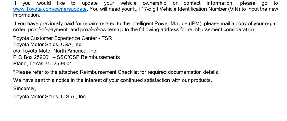

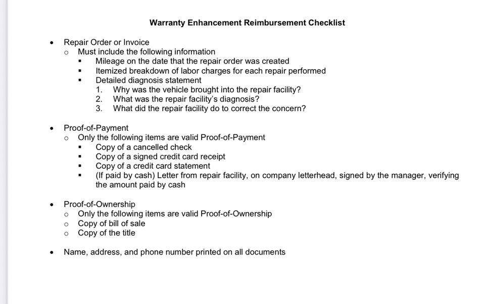

    Toyota often makes future "warranty enhancements" reimbursable if you already paid for repair.
    In your case it is a big job requiring dash removal for most servos. If you do pay for repair, consider using a reliable lower cost independent but keep necessary documentation and inform the shop.
