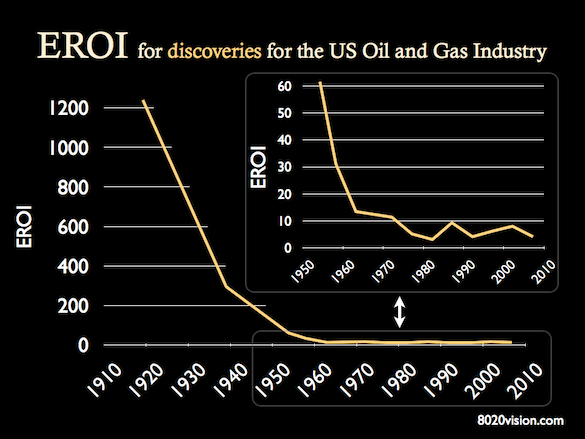

    But why consider Well-to-wheel efficiency . what matters the overall efficiency.. Which must include discovery. The following image shows the energy-return on energy invested for just oil discovery..
    For the Discovery chart above, note that in the early days of oil exploration, the stuff was practically bubbling out of the ground, so it was much easier to figure out where to drill – hence the EROI over 1,200 in 1920. As the US industrial age found its legs, oil consumption accelerated. Demand for more and more oil quickly consumed the easy stuff, and the EROI fell rapidly. As we hit peak oil production in 1970, the EROI fell below 10:1. I inset a blowup of the chart, from 1950 to 2010, so that we can see how EROI has since remained firmly in the single digits. Note the "discovery" process does apply to NG, tough still at a much higher EROEI, and for coal the discovery process is minimal and overall EROEI for coal is about 80.
    As the current discovery EROEI is in the single digits, currently about 1:7, and is multiplicative, then even if you presume production efficiency is 80%, the total EROEI is .85*.80 = 68% for Lifetime energy efficiency to produce gasoline.

    Very interesting post Ddrinnovation, thanks. Do you have similar EROI data for extraction (mining) of oil and coal ?
    It reinforces my point, however: if I pull up to a petrol station after choosing petrol vehicle 'A' or vehicle 'B', the upstream pollution losses and conversion efficiency, while certainly variable over time and place are nonetheless the same for that refilling. All I can do to affect the result is pick a higher MPG vehicle.
    Likewise, if I pick an EV with a higher miles/kwh than an alternative EV, I have made the smarter EV choice.
    What I cannot do is assume that just based on a higher MPG(e), an EV is a smarter environmental choice than a petrol vehicle with a lower MPG number.

    When one factors in the huge decrease in discoveries, it's worth noting that the paltry new discoveries are nothing in comparison to the mega fields of the middle east .... which in some cases have been pumping & pumping for over a half century. So, not only have we made less discoveries, the paltry ones are, well, just that ... small in comparison to what we'd like. Couple that with the inevitable ... that the mega fields can't last too much longer, which drives up demand/costs. THEN, your new discovery costs go through the ceiling, because that old discovery energy that you use to find the new energy is costing a lot more. End of wet blanket.

    To nitpick a bit, IIRC the EPA says energy refining costs of oil to petrol are 15%; and if I am reading 1:7 corrrectly (the EROI) for oil, 1 in 8 parts of oil are used in discovery, or 12.5%. So the partial lifecyle would then be 0.85*0.875 = 74.4%.​

    Not sure which nit you are going after.. in part becuse the numbers were rahter similar.
    An EROEI of 7 means that a investment of 1 returns a total of 7 (with a net gain being 6, not a net gain of 7), so it is 1 part in 7 is used for discovery or 14.2% (which I rounded to 15% for simplicity) to get the formula
    .85 (discovery penalty) * .80 (refinery) = .68
    I got the 80% as follows.
    According to the 2008 Argonne publication (using data to 2006)
    Argonne GREET Publication : Estimation of Energy Efficiencies of U.S. Petroleum Refineries
    Efficency of the refinery (ignoring all transportation issues) for gasoline (excluding less desirable products such as road tar) was 83.3% (and its 87% if one inclues less desirable products in the energy mix), so the average of 85% efficiency is commonly used. (Note the GREET model pushes all added energy for shale oil and tar sands cracking "upstream" (i.e. does not consider their heavier processing burden) and also EXCLUDES transportation losses. (I don't know any good sources on that energy usage).
    So I did start at 85% for refineries as of 2006
    In the link I cited, on more recent issues in refinery efficiencies it said the US refineries have lost about 5% in efficiency since 2005, which is why I reduced from 85% to .85 * .95 ~= 80% refinery efficiency. Since the greet model was 2006, so some of the loss was already beein measured and I rounded crudely, I guess I should have made that 81%..
