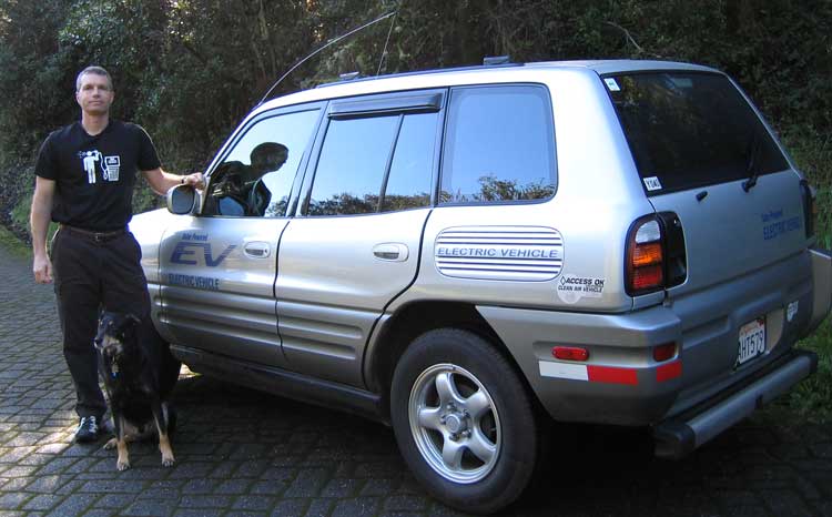

    Well, while we're showing pictures - here's one too. Same deal. Solar on the garage roof makes more than the car consumes.
    Car model first built in 1996. This particular 2002 example is most often found in MY garage.

    Are we still talking about "in the mind" as well here? Because, really, it is the other way around. Battery cars begat the Prius... and we're now slowly working out way back to battery cars. (not in the mind, but in the physical world).

    Thanks for the link. It started me on a whole journey around wikipedia and google. Thanks! :)
    Wow! Why does that seem so expensive? You can buy solar panels on Amazon.com for $350. I don't get it. Yeah, I understand that it is "installed," but it can't cost $5000 in labor to hook up the wiring, slip in a computer chip, and load some [already developed] software updates. (I'm scratching my head. What am I missing? Perhaps it has something to do with "overhead costs" and PROFIT?)
    Ah, I see exactly what you are saying, sunlight varies, but you want the car to operate on "cruise control" or if you drive under a bridge, you can maintain speed for a a few seconds. Makes sense. As far as aerodynamics, that's why I keep saying that the next Prius should be shaped like an Aptera http://www.bcnv.org/Conservation/mediavault/Aptera.jpg It would probably sell very well as a "cool"/novelty item. Although I don't have anything on the top of my head right now, but I usually have hundreds of questions for "is anyone here an electrical engineer?" I think I'm going to go back to school and take a few classes in electrical engineering. (I'm a biochemist, and I work on research, developing GM crops).
    PV-to-100% electric! Heck, with that sticker on your car, they shouldn't just let you drive in the carpool lanes, they should let you drive down the shoulder of the roads, in the emergency lanes! :D (think rush hour in CA )
    Awesome dog, btw. Is he/she one of those rare Australian-German Shepherd police-search dogs?
    You should have the image on your t-shirt made into a vinyl sticker that you can put on the rear window of your vehicle. :)
    I'll give you 0.5pts for suggesting ... causing me to think :D that since batteries are not 100% efficient, having some solar power on the actual car, bypassing the battery, and connecting to the drive motor would in fact be more efficient than deriving 100% of a car's electricity from an external source.

    I figure that with three of us in the EV, crossing the bridge should be a net money-maker for us!
    Oooh. He'd be so proud that you think so highly of him. He's a rescue mut from our local SPCA. His mom was mostly Queensland Healer (judging only by the looks) and dad was never found. He's 11 now, and we've had him his whole life.
    I wish... but I don't hold the copyright.
    This totally depends on how you define efficient in this case. You've paid for the PV. You pay for the extra weight and air resistance of having on you car - even when you drive at night, in shadows, etc. I still contend that there is NO practical reason to attempt to supply your traction power with PV directly on the vehicle. It doesn't pencil out in energy credit, or financial credit.
