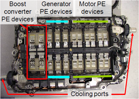

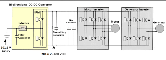

    Here are some pictures of the 3rd Gen Prius inverter module and schematics. Taken from the Oak Ridge National Laboratory publicly available document "Evaluation of the 2010 Toyota Prius Hybrid Synergy Drive System".
    Inverter Schematic.

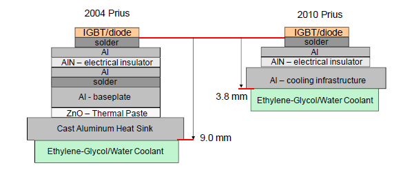

    Pictures of the IGBT and heatsink structure. Obviously heavy duty. Silicon attached directly to water cooled block. Notice how the boost converter has the fewest IGBT and the traction motor has the most.

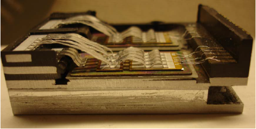

    Close up of boost converter IGBT modules. You can see how the leads are attached to minimise thermal stress. It is also immersed in a gooey coolant not illustrated here.
    Improved power electronics cooling when compared to the Gen2 Prius inverter. Note, fewer layers and lower thermal resistance for the power electronics.

    Freaky!!! Inside that PCU is pretty scary...
    The Oak Ridge National Laboratory document is fascinating though. Toyota must be feeling a little miffed - I know I would be...

    Beaut. There's the transistor to ground, the inductor, the rectifying diode, and the filtering cap components in all their glory. There's an IGBJT in the upper leg; however, I happen to know that, unlike MOS transistors, Bipolar Junction Transistors (BJT) are unidirectional devices; that is, current can only flow one way. Since these appear to be NPN transistors (the arrow points out on the emitter leg, rather than in), current can only flow from the collector through to the emitter. Therefore, the upper transistor is used as part of a buck converter; that is, its purpose is to takecurrent from the motor/generators and dump it into the batteries.
    The pictures are interesting but a bit confusing, especially trying to match up the stack-up with the picture. In the stack-up, the only place there's solder is directly under the IGBJT/diodes; but, in the picture, I'm not seeing die, but something else. In any case, it appears that that one batch of solder is where things are breaking off; I think I'm still going along with the instantaneous thermal stress theory.
    Boy, those are some small, naked leads there on the right! Looks like bond wires on a die..
    So, when they inspect these things, do they take the lid off and look for physical damage? Wow!

    Those leads (especially the small signal ones on the right) looks so random and roughly formed. No precision, automated, robotic manufacturing there, obviously. If I was turning those out and had this photo published here, I would certainly be embarrassed!
    The electronic design is also very disappointing to me. Do they moderate the DC rail (below 650V DC) depending on load, or does it always run at full voltage, does anyone know? Maybe it's in the Oak Ridge document but I pretty much only "looked at the pictures" so far. ;-) If so, that would mean 650V is always being applied to the motor windings, in a metal contaminated oil bath. Hardly seems like a good combination to me. I now start to wonder if the high aluminium levels seen in the Transaxle ATF Oil Analyses are due to electrolytic corrosion, and maybe some of the high iron (and aluminium) levels are due to EDM (Electric Discharge Machining) very commonly seen in electric motors (in their bearings) running off (or near) Variable Speed Drives.
    I would much prefer to see Dual DC Rails, one for each MG, and for these rails to be individually voltage regulated, according to the power demand. But maybe, it's much easier to feed the output of one MG straight into the other this way. Hopefully, the voltage is moderated at least. I guess it has to be, thinking about the regen voltage graphs I glanced at last night. Maybe not so bad then.
