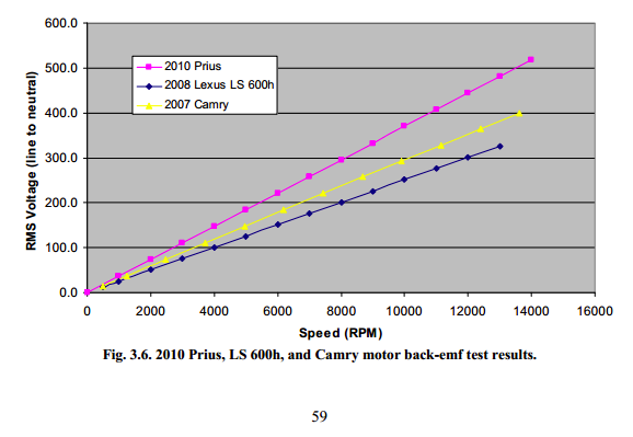

    All right. I think I'm confused about the numbers. Here's the graph from earlier in this thread:
    And, no, I don't know where this graph came from, which MG (1 OR 2) it's associated with, and so on.
    For the moment, however, let's suppose that you got your numbers straight: At 120 mph said MG is rotating at 12,000 rpm.
    Then, the RMS voltage of one winding to neutral will be 450V from the graph above. However, we know from the schematics that the neutral doesn't seem to be connected anywhere, but we do have connections across two phases, separated by 120 degrees. Phase diagram is | 1/_0 degrees - 1/_120 degrees | = 1.732 /_30 degrees. Fine: so the rms voltage across two phases is 450*1.732 = 779 V. But, that's the RMS voltage: The peak voltage, which is what one is going to use when one wants the diodes to turn on, is 779 * sqrt(2) = 779 * 1.414 = 1102 V. That's a lot of volts. And that's open circuit, too, but that's not where we're going.
    So, 120mph/1102V = X/200V, or X = 120mph * 200/1102 = 21 mph.
    Hokay. My numbers are somewhat more aggressive than your numbers. I think that that 650V that you're quoting is the measured bus voltage when in regen or when the boost is on; but, in that case, we're drawing current out of the motor and that drops the voltage. (He scratches his head, tries to remember motor current equations, mumbles some more about resistances across the windings of transformers, and hides his head in shame from his EE 362 prof.)
    In any case, that 200V peters out long before we get down to the 5 or 7 mph that we know is the threshold of regen, so, you and the other guys are right: there has to be a boost mechanism running with the windings of the motor as inductors. Or I've forgotten a factor of two (peak-to-peak voltages, anyone?) somewhere.
    KBeck.

    It comes directly from the Oak Ridge National Lab report, page 59. (I left that on deliberately, to make it easier to find.)
    You raise a very good point about which MG it relates to. Surprisingly, from what I read in the report, it is not obviously stated which MG the graph pertains to. I imagine it's MG2, but even that is muddied by the fact that, for reasons of their own, they prefer to confuse matters further by referring to MG1 as "generator" and MG2 as "motor", and even referring to the "motor" as the Prius PMSM, when in fact both MG are exactly that, motors and generators, and both are PMSMs. However, I would also suspect that both MG1 & MG2 have similar BackEMF voltage/speed performance, even though MG1 has about half the power capability.

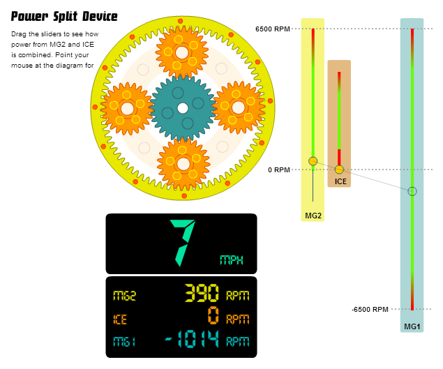

    Not sure which Gen Prius this applies to (from eahart site), but it shows the speed ratio between MG1 & MG2 with ICE stopped.
  7. jdcollins5
    jdcollins5 Senior Member
    Aug 30, 2009
    5,131
    1,346
    Wilmington, NC
    That PSD is for the Gen 2. The Gen 3 max speed for MG2 is 13500 RPM but there is a Speed Reduction Unit with gear ratio of 2.6 to 1 between MG2 and the wheel.
