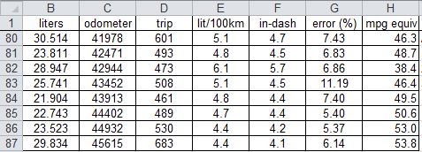

    Here's my last few tanks. All the errors are on the optimistic side, in case you haven't guessed. The 11.9% is an aberration, I'd disconnected the battery to do a brake job.
    Sure you can apply the Toyota exaggeration factor, but come on... This is not due to limits of accuracy, or the errors would be falling on BOTH sides.

    Yep.
    My impression is that the meter is pretty darn precise, with a ~ 5% positive bias.

    It's kinda interesting that the last few tanks, with lower liters per 100 km (higher mpg), also have lower error.
