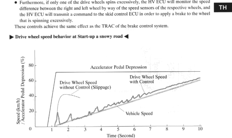

    The first-gen Prius (2001-2003) did indeed have a "traction control" that could not do anything but limit power, and was really only there to prevent the magnets in MG1's rotor taking an unscheduled departure from the car.
    With Gen 2 (2004 on), there was a traction control like those in other cars, where it can detect if a particular wheel is slipping and selectively apply the friction brake on that wheel, keeping more power available to the wheel that isn't slipping.

  5. ChapmanF
    28,705
    19,006
    See page TH-47 of the 2004 New Car Features manual.
