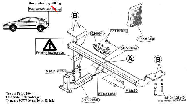

    Very interesting discussion. May I ask, how do you install the hitch?
    Greetings from the Netherlands.

    I got my bar at Marktplaats*. This is an 'official' bicycle-bar (scroll down this link) with a square hitch, supposedly developed by the Dutch importer of Toyota. It bolts onto existing threaded holes in the chassis. I only had to cut a little slit in some underside plastic and it fit like a glove.
    I bought a separate construction (also Marktplaats, see above link) that slides over this square hitch and has a round, typical Dutch ball-type hitch which is then fastened with nuts.
    In total I payed like 120euro or so, also mainly due to shippingcost from two different sellers. Mind you, they were both secondhand.
    Stupidly expensive if you compare this to the brandspanking new hitch INCLUDING electronic box (so the CAN-bus won't complain) and socket for my father-in-laws Renault Espace which was under 100euro (86euro+shipping)...
    The Prius does not seem to have canbus problems so I soldered most of the wiring for the electrical plug into the steeringwheel-side (left) of the car near the rear light.
    Mail me if you get hold of one and want to see where I cut the plastic protection on the underside.
    * Marktplaats is pretty much the Dutch Ebay. So much so that when Ebay couldn't get a decent marketshare, they eventually bought Marktplaats ;)
