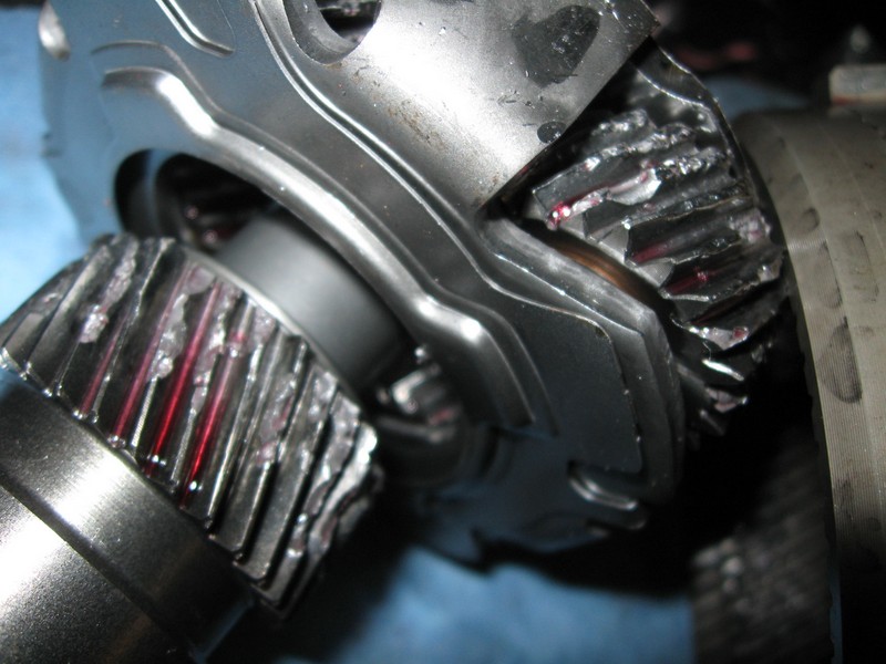

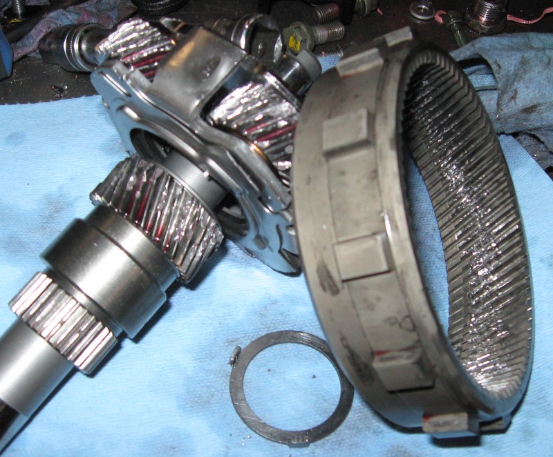

    I recently worked on a 2006 with 140K miles that presented with the following symptoms: The hybrid battery was at 1 bar; the ICE would not start; the car was in Ready, but there were no codes. As I let it roll off the flatbed wrecker in Neutral, it felt "lumpy". If you have ever pushed a car (or run out of gas in one) with a manual transmission that was in a high gear, engine off, it felt just like that. I popped the hood and could see that the engine crank was turning while the car was being pushed in Neutral. What else turns with the wheels? MG2, or more specifically, the MG2 ring gear. What is the only way that the wheels could turn the ICE crank? The planetary carrier pinions were locked to the ring gear. Surprisingly, while I was looking at things, it did manage to start the ICE -- pushing it around must have freed the carrier pinions -- so I let it charge the hybrid battery. It was basically the worst metal-to-metal noise that I have ever heard! I pulled the drain plug and saw about a teaspoonful of large metal chips on the magnet. The fluid condition itself was very good, not the black factory fill crap that I am used to seeing come out.
    I gave the owners the bad news, that they had a ruined transaxle, but also the good news, which was that I had a good transaxle that I had just removed a couple months ago from a car that we had stripped, I was willing to let it go for cheap, and we came to an agreement on price. If you are faced with having to pay someone to replace your transaxle, look for a place that will charge 8 hours of labor, about $100 for fluids, seals, and axle nuts, and anywhere from $500 to $1000 for a salvage trans.
    Finding the root cause was very important to the owner, who had performed fluid changes at 60K and 120K miles. I broke apart the bad trans to verify the diagnosis of a bad planetary gear set. Planetary gear sets are in virtually all automatic transmissions, and I just did one out of a Dodge van that was stuck in reverse due to having the carrier/ring gear/sun gear locked as one. Here is where it gets interesting. As soon as separating the MG1 housing from the rest of the unit, I found the MG2/planetary flange shim floating loose in case next to the oil pump pickup. The only way it could have made it there was due to an assembly error at the factory. The excessive clearance between MG2 and the planetary flange, then caused "premature" wear in the ring gear/pinions/sun and led to the failure.
    Going clockwise from the bottom left, the input shaft, sun gear, planetary carrier + pinions, ring gear, shim.
    Close-up of severely worn "chewed" sun gear and a pinion gear.

    Thanks for the pictures and the details.
