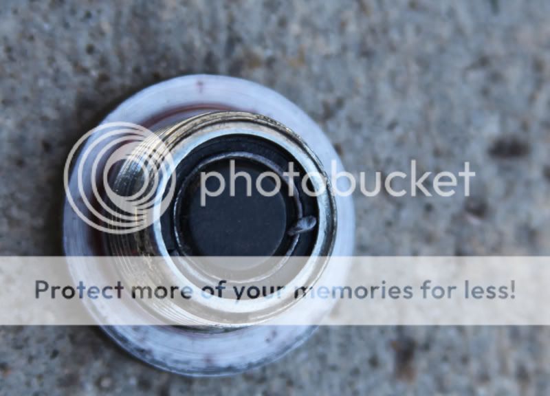

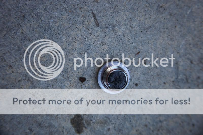

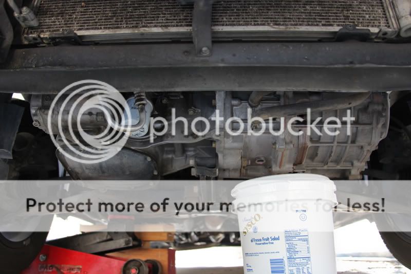

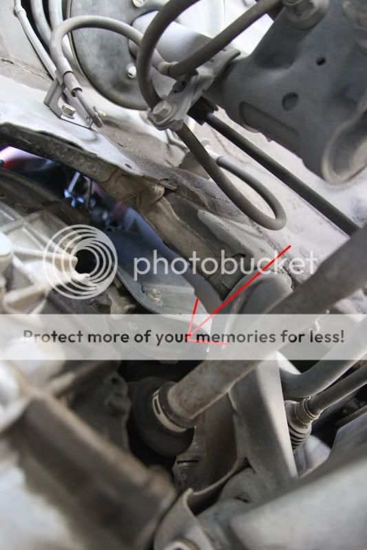

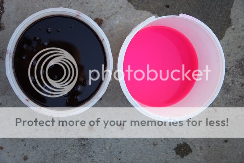

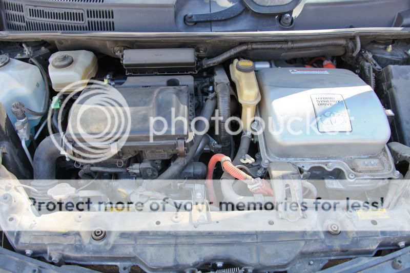

    Here are some photos from the weekend:
    My Current Projects:
    One of the smaller pieces of metal that came out with the ATF.
    The Fluids.
    A good amount of build up on the magnetic drain plug.
    A good look at what I have ahead of myself.
    Top view...
    Leak on back of transaxle. Or this this not part of the transaxle? It is right above the axle....
    raffpoz likes this.
  12. Patrick Wong
    Patrick Wong DIY Enthusiast
    Mar 8, 2008
    18,210
    6,517
    Green Valley, AZ
    Thanks for posting the photos. I really can't see where the leak is.
    Is there any possibility that the inner CV joint boot is leaking grease, and when the axleshaft is spinning, grease is being deposited all around that area?
    The transaxle fluid looks quite nasty while the coolant looks like punch that you wouldn't mind drinking...

    I first thought it was the CV joint when I saw the fluid, but then when I looked closer it appeared to be coming from a seal right above the CV joint.
    Yes the transaxle fluid was nasty, I filtered a little bit of it and it was completely full of junk, while the coolant looked perfectly clean.

    The leak area is the area where the transaxle oil pump is located.

    Your photo of WS fluid at 127k miles should be must-viewing for anyone who regards it as a lifetime fluid in the Prius transaxle.
    C'mon boys and girls, grab a wrench and a gallon (OK 4.5L) of WS! Don't make your gears swim in that!
