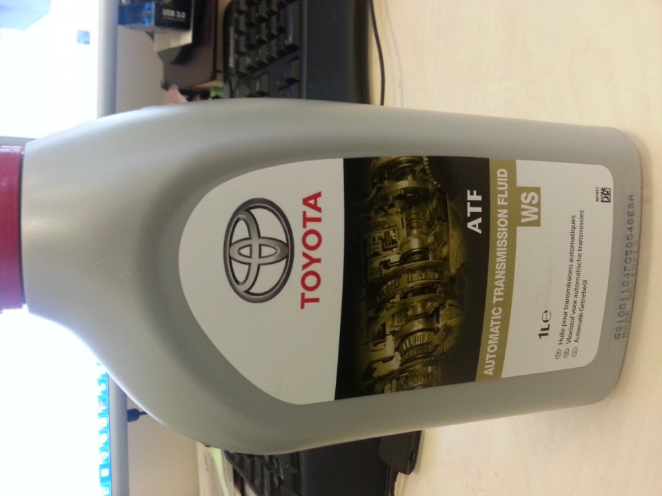

    toyota seems to use Red fluid ATF WS into Prius cvt's. The part number for 08886-81210, the bottle does not say anywhere that it is for CVT's. However EVERYBODY uses it.

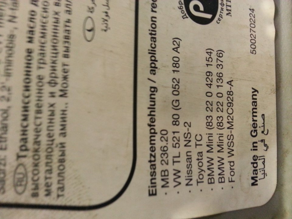

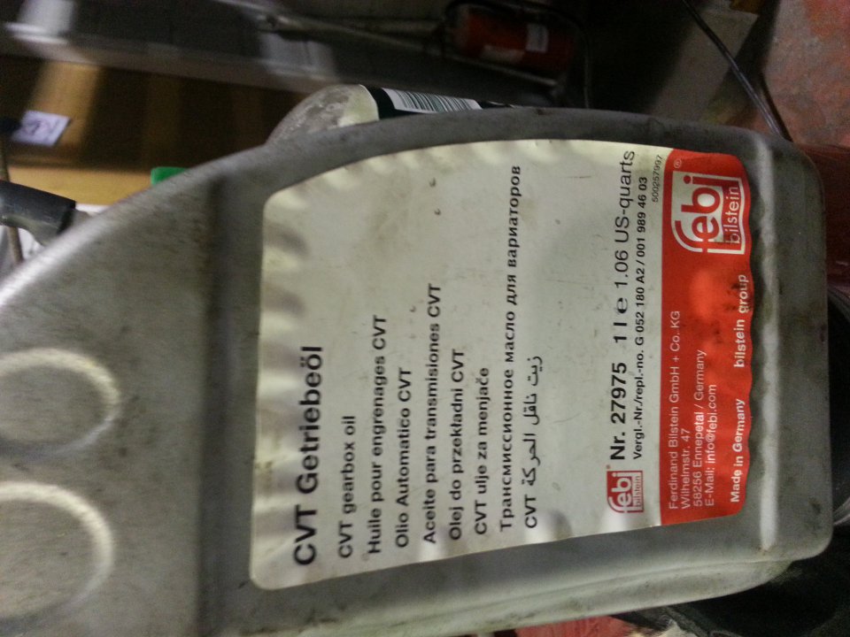

    this is what mechanic used in someone's Toyota VITZ (attached pict's)
  4. Agape
    Agape Member
    Nov 1, 2010
    378
    Ireland/Eire

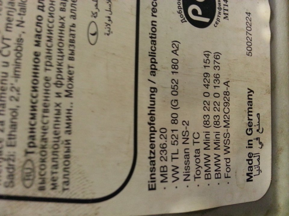

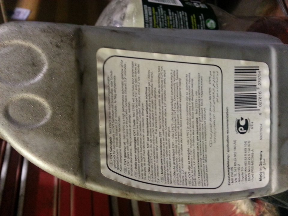

    This is what I got (attached picture):

    Conclusion: Red ATF WS will go to my prii.
    Ordered alu washer.
    Thanks everyone, Britprius, your sense is very correct. The terminology made me to think in such a way.
    Patrick and Mendel Leisk, thank you once again.
