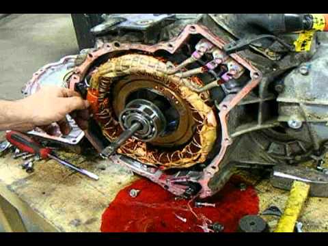

    Here is one opened up, you can see the remaining fluid is minor.

    Yeah as far as I know, most of the fluid drains. I'm looking through 2007 Owner's Manual pdf, was hoping it'd show both the drained and overall volumes, but no such luck.. That's my take though:
    You've maybe bought 4 quarts too much, lol? I don't know what I'd do. Considering it's likely never been changed before, maybe do the second change not that far into the future, say in a year. Just so you're not sitting on the stuff so long.
    I've found the most important change is the first one: subsquent changes, the fluid looks more and more indistinguishable from new.
    Do have the car level when filling, and just fill till it starts coming back out. That's the key to correct level.

    There’s a small amount left in the fluid pump galley. There’s a pump and a small inlet filter that cannot be serviced without trans disassemble.
    My observations and having done a trans UOA is your one trans fluid change should be good for the life of the trans. The majority of wear happens at the first 5000 miles of life during break in.
