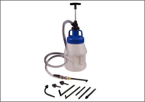

  15. atikovi
    atikovi Junior Member
    Aug 18, 2005
    68
    Great write up but I have a few questions.
    1) I assume it's better to have the fluid fully warmed up?
    2) When filling, does the car have to be level? I would drive the front up on ramps so it would be 8 inches higher.
    3) The picture shows you filling from the top. I thought the fill plug was just above the pan and reached from under the car?
    4) To clean the pickup screen can you just spray it with brake cleaner? There is no mention as to how specifically it's cleaned.

  17. atikovi
    Aug 18, 2005
    68
    Thanks, I'll be using this filler to make it easier though.
