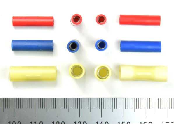

    Should I put something around these wires other than electrical tape ?
    I used some of those crush style splicers where you out the wire in it and crimp it down.

  20. ChapmanF
    28,638
    18,959
    You're right, imgur is being stupid, so I don't see the splices you used.
    These are the good stuff, as spec'd by Toyota:
    They are parallel splices: the two stripped ends of your wires overlap in the middle, and you crimp down the barrel to smash both stripped copper ends together, and the current is carried right from one wire to the other.
    Auto parts stores for some reason more commonly sell butt splices. You can recognize them because their middles are narrower than the ends, and longer than the middles of the parallel splices:
    They look similar, but your two wire ends don't end up overlapping. There's a stop in the middle. One wire goes in one end and stops, one goes in the other end and stops, and you crimp both places, and the current has to flow through the splice barrel.
    And then there are these kinds of things, that only conduct through one little blade that mashes down through the wire insulation:
    Those are really not the ticket. But if you used one, and it worked, I would probably call it a day, and if it flakes out later, just replace with a better splice. Maybe it never will.
