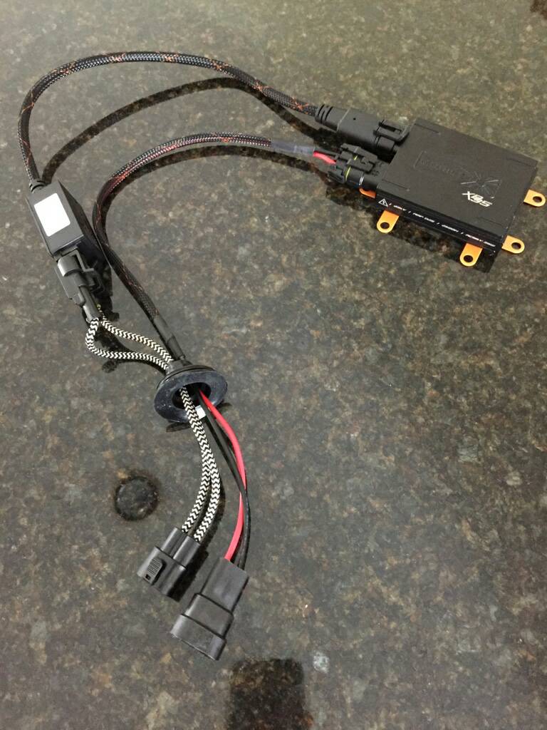

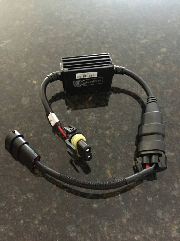

    So your saying I can remove the Canbus entirely? I tried to turn on my lights without it, but it wouldn't work. How would everything plug in? Here's a picture .

    Yours is a little bit different. The black and red wire go to the bulb harness while the zebra print line goes to the HID bulb

    Ok I removed the Canbus. When I manually turned my headlights switch on nothing happened. When I turned it on and off 4-5 times the bulb finally turned on. I waited a few moments and did it again and the headlight seemed to turn on constantly. Should I still be concerned?

    Since I removed the Canbus relay both headlights seem to be in perfect working condition. I'll get together with TRS on Monday as well. Thanks y'all.
