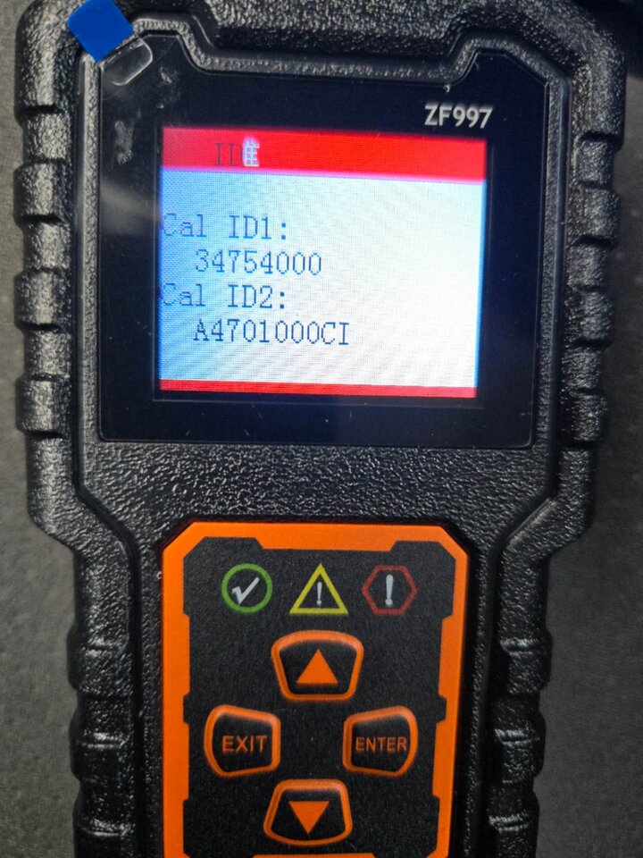

    I found the ID
    2014
    Does it need to be updated?

    Depends. What car is your id from? A 2012 as in your profile, a 2014 in your post, a hatchback, plug in or v wagon?

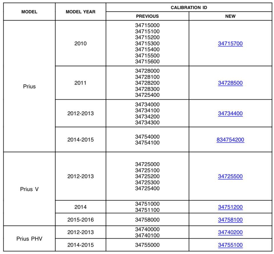

    I believe the latest calibration ID for your 2014 Prius is 34754200. It does not need to be updated. Your car will still run with the "old" calibration ID, but you might want to have it updated to make you feel better knowing that you have the latest and greatest update.

    The 2014 should have the updated egr valve and could have the revised pistons and rings based on its vin.

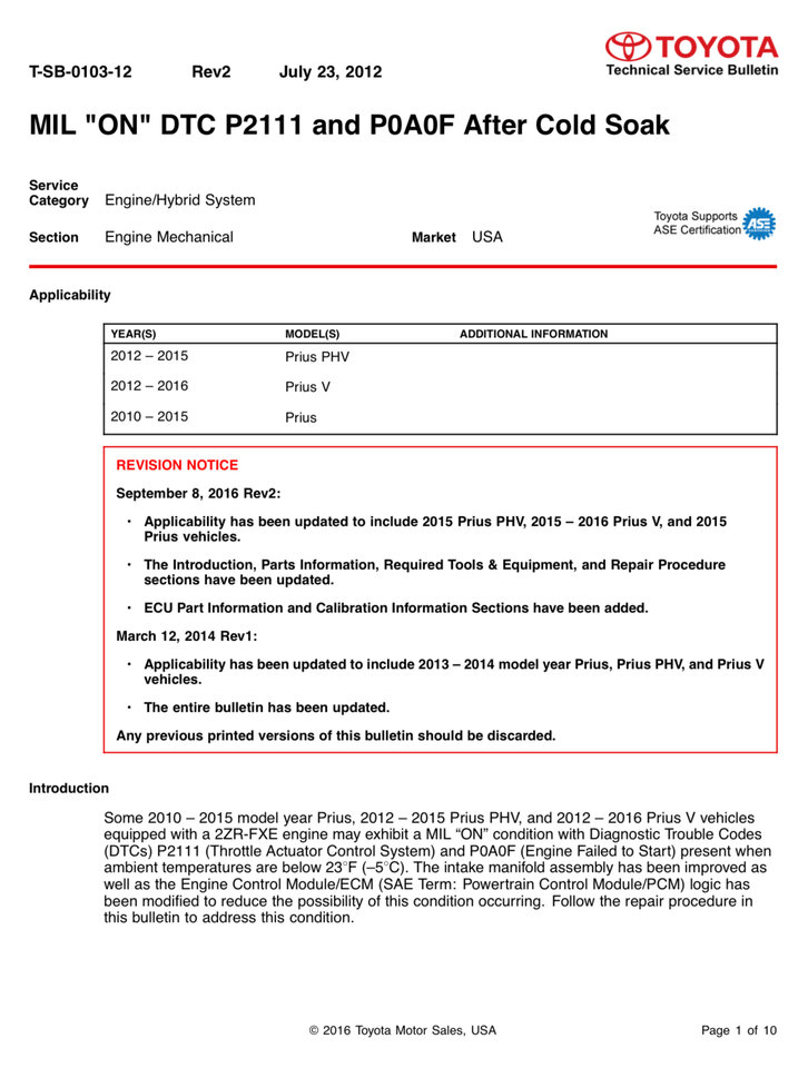

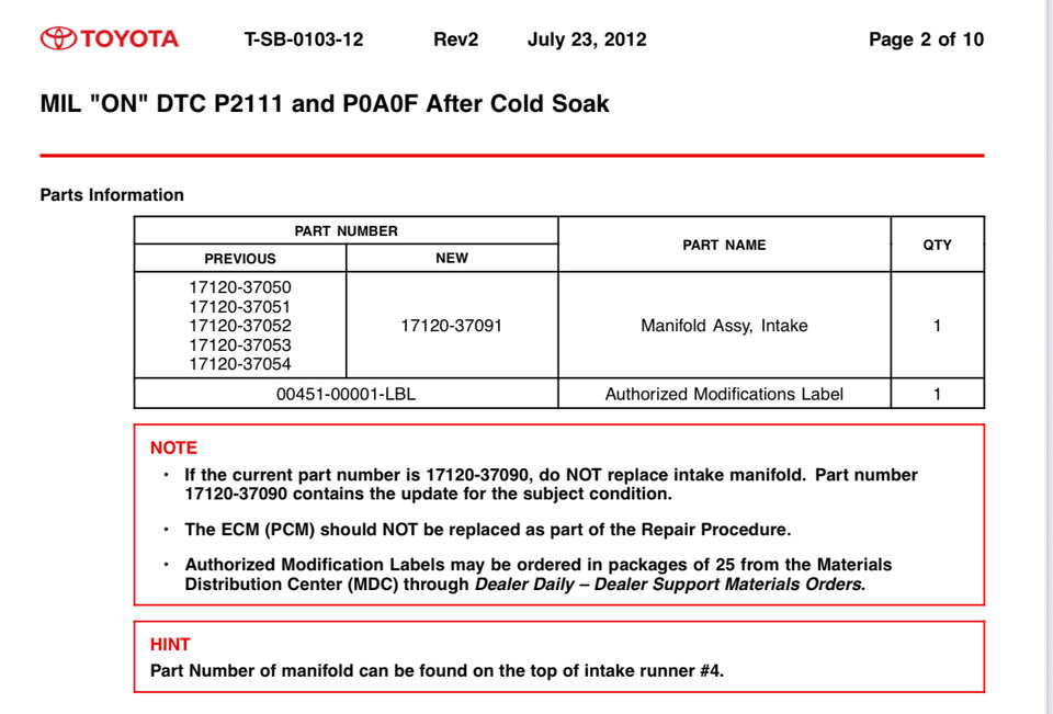

    The one tsb I found that updates the ecm as Brian noted is for a revised intake manifold.
    There never was a US tsb about the head gasket similar to the European tsb but some of us updated the ecu assuming any known improvements to the logic would be incorporated. In Europe and Japan the gen3 engine was used in their Prius v equivalents for many years after it was replaced in the US.
