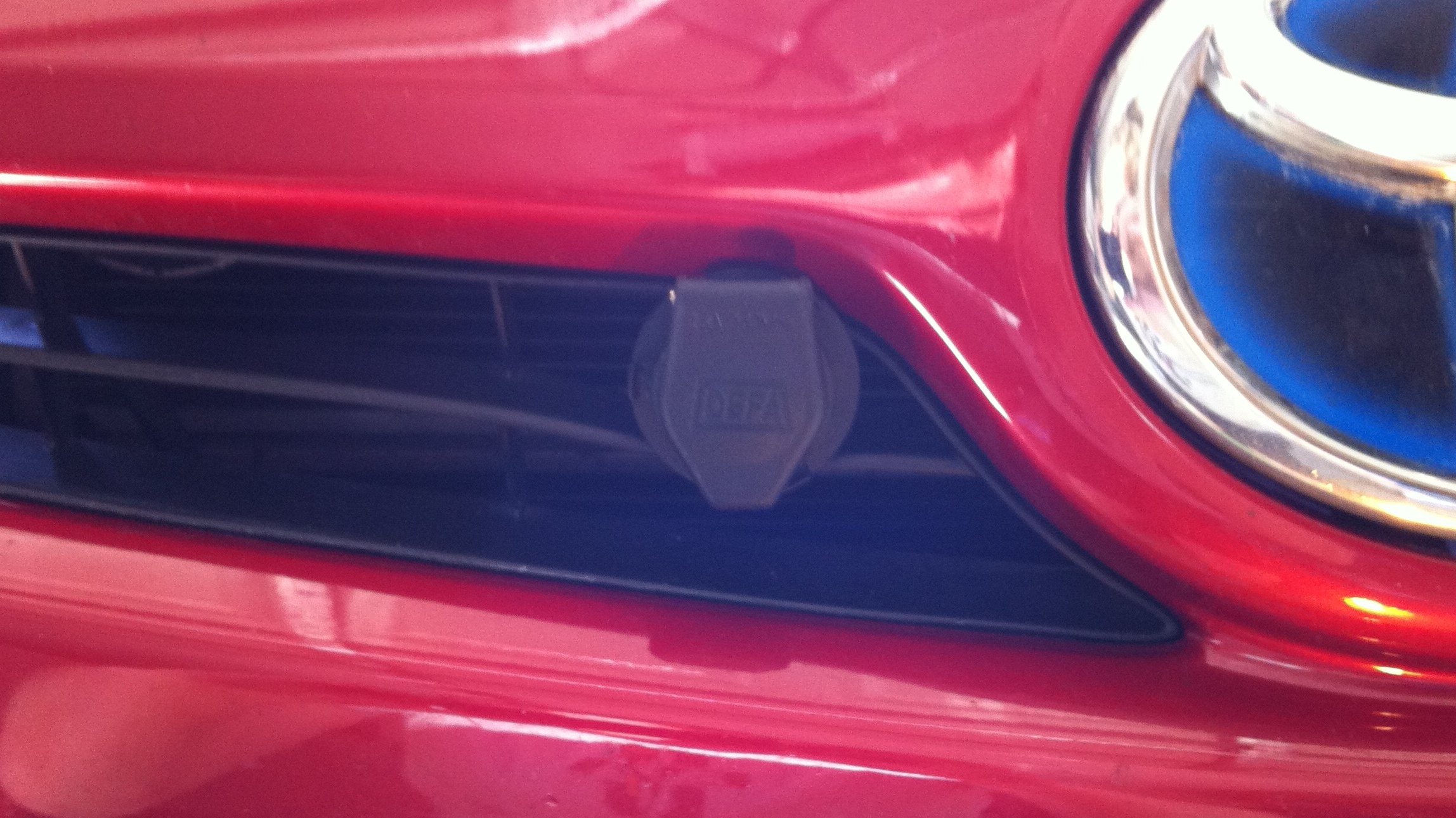

    As an alternative, look at the DEFA pre-warming solution from Norway.
    Here's my journey to get one and fit it myself. In the end, it was fairly easy, but as you can see I had to make a few discoveries first. There's no DEFA fitting agents in Australia... Waeco are associated with car fridges and refrigerated seat covers in Australia!
    IMHO the DEFA is much better integrated and "resolved". The water-proof fittings, the ability to add a cabin heater and battery charger make it worth the extra.
    When I was looking for an EBH last year, there was no 240 volt version of the "Canadian" EBH. I stumbled across DEFA and was sold.

  7. edwardob
    edwardob Member
    Sep 26, 2009
    227
    ireland
    nice write up on installation........but there is a 240v available and part no quoted above
    i route mine down behind number plate thru the foam ...so it is hidden and facing down looks part of car
    [the black on the grill is just grill blocker]

    Hi Edwardob
    So you run the cable from the EBH under the engine? Where do you earth it? I toyed with that idea, but decided that the negative terminal was the right place to connect and there was enough clearance without drive belts in the way. And since the socket will only feed in from the outside, you've got to get the routing decided. Fortunately, my long arms will reach over the back of the engine, so I could unplug the cable from the EBH and try another route.
    The DEFA technical notice provided to its installers (and provided to me by Bjørn) has the plug on the lower grill on the right (left, if viewed from the front). Not only does this interfere with lower grill blocking, it takes the cable too close to A/C tubes in the cramped space on the right (left if viewed from the front) entering the condenser for my liking.
    If the visitors to my blog from Norway, Sweden and Finland are anything to go by, the instructions "keep cable away from A/C and brake lines" aren't adequate for the DIY installer. Google "defa ebh install prius" and you'll find my blog. The responsibility weights hard.

    no over the engine...well between the engine and big electric thing...kinda goes down the middle.....then pushed tru foam above radiator[little ap] and the wriggle it tru bumper foam

    Eek! It ends up as a nice stealth install, but I can't imagine how much skin it required.:)
    When I was on my back staring at the rear of the engine and wishing to avoid the A/C lines on the right, I couldn't find a safe route to avoid the exhaust manifold on the left. Without a bracket I wasn't sure that the cable would stay away from it.
    I considered the left (looking from the rear) is an easy path to the lower grill as there's a nice opening covered by foam with nothing else running through it. But I couldn't find a safe way from there. That's the best path for the Canadian EBH because it is near the top of the block, but not a model for the DEFA install, if you ask me.
