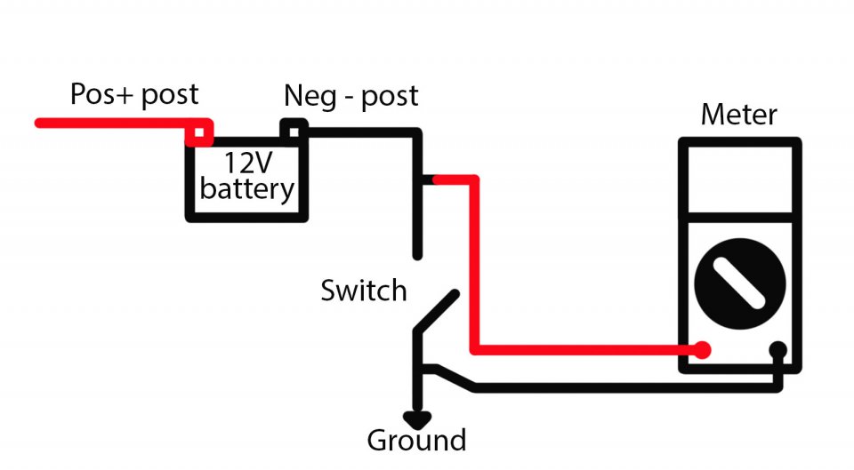

    WOW! Some really fun stuff here :ROFLMAO: First off, you can't break the circuit between the battery connections and get
    a proper amperage reading. The ECM and other control modules will power up every time you reconnect it with the meter. You're gonna need a switch between the negative post and the cable to do a proper parasitic load test.
    You need to install the switch and close it. Start the car can allow it to run for a minute. Shut it off and hook the meter across the switch like my drawing shows. Turn the meter on, close all the doors and reach in through a window and open the switch. Check the amperage draw and wait for it to drop. It drops as the computer control modules go to sleep.
    Some take up to 20 plus minutes to shut down. Your amperage draw should drop to anywhere from 20 m/a to 50 m/a.
    Anything over 50 m/a should be considered an excessive draw. In a perfect world a 35 m/a reading is ideal.
    You can also trip the latch on the door/hatch and leave it open to gain access to the battery. As long as it turns off dome lamps, it's okay. You can't disturb the system while the switch is open or it could blow the meter fuse. It will also power up the modules. Make sure and remove the key from the car and place it far enough away that it can't detect it, or it will keep the system active. I suggest you get your good meter working for this job.

    Thanks all for the assistance. Troubleshooting while stressed and at midnight is never a good situation.
    Battery is on trickle charger to top it up from 10.5 V to ~12-12.5 V. I'll have to reinstall and continue testing tomorrow evening.
    Patrick Wong - Good writeup. That is pretty much the the procedure that I used, but I tested at the battery versus the battery post under the hood. The one difference is I left the rear hatch open, which definitely kicked on some of the ECUs and electronic components. Testing in the front is probably easier since there is no hood switch in the factory alarm. As an alternative, presumably we can leave a door open as long as the door plunger switch is clamped in the closed position, correct? Is the door ajar only measured by the single switch per door?
    Britprius: There was no voltage drop associated with the current drop. Voltage throughout testing was within 0.2-0.3 V range (approx 10.7 - 11.0V). Also the drop from 1.5A to 1.0A, was instantaneous, not gradual. It happened twice but could not be reproduced. I think it might have something to do with the various ECUs dropping to sleep mode as Drdiesel suggested.
    Drdiesel: Good info. I didn't even think about the SmartKey being in my pocket. I'm surprised the ECUs take that long (20 min) to go to sleep. I have a battery post switch, but I'll have to leave the back hatch open to access it as I can't access it from a window. Since it's easier, I'll try Patrick's method first to see what the immediate current draw is upon reconnecting. This may not be the exact parasitic load, but it may be good enough to help me diagnose the problem. If it's 0.1A or less, then it may be a battery or charging issue and not a drain or parasitic load issue.
