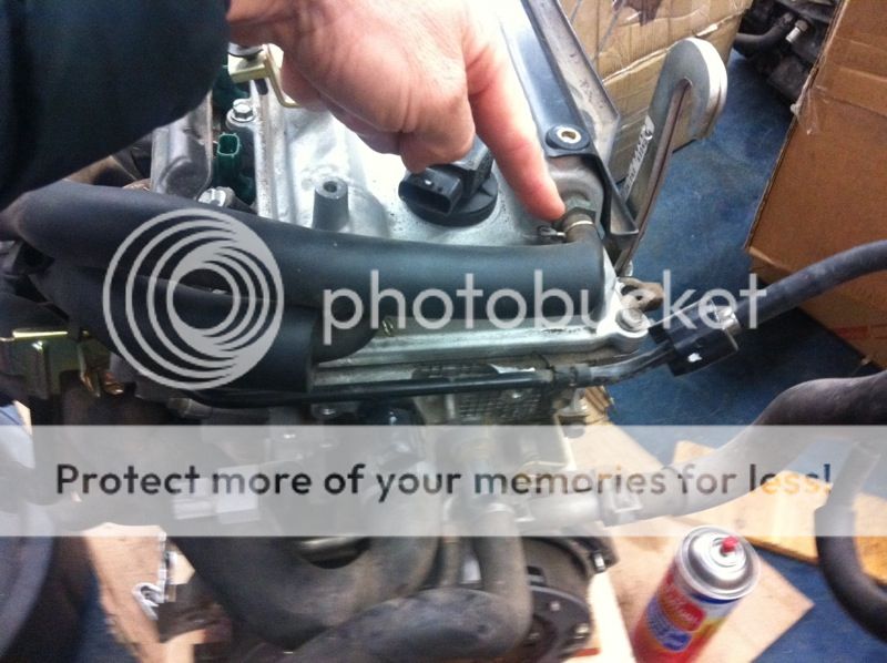

    Im hoping my local autozone has one. at least im guessing these cars have one of these.
    EDIT: I just checked autozones site, they have one 4.99, judging by what looks like threads, I would say it screws into the valve cover.
  7. 3prongpaul
    3prongpaul Hybrid Shop Owner, worked on 100's of Prius's
    Jul 18, 2010
    956
    735
    Boulder Hybids, Boulder, CO
    Have fun with the PCV valve, it's a PITA to access.
    You'll need to remove the wiper cowl assembly and move aside the wiring harness on top of engine. When the engine is out of car it looks easy and accessible...in the car it's a whole different story...

    Oh yeah the pcv sucks...but removing the cowl will also make ignitor check easier. While your in there replace the spark plugs too. Your due. Might as well if the ignitors are coming off. Lot of work getting to pcv might as well capitalize on it.
    Do you have an air compressor? I recommend you give the spark wells a good blow out before removing the plugs. And if you see any corrosion in there before removing the plugs spray the wells good with carb cleaner than with a towel over the hole blow that cleaner out with compressed air. Towel so cc does not get on paint. Then wipe off valve cover real good too especially around mating area of ignitors with cc. All before plug comes out so none of the crap gets in the piston chamber.
    Make sure you have dielectric grease for ignitor boot when replacing ignitor.
    Btw, have you checked the water dam seal? Is is it unglued and or falling apart?
  10. 3prongpaul
    Jul 18, 2010
    956
    735
    Spark Plugs are not too hard to change with wiper cowl installed, but a little easier with wiper cowl removed. Suggest buying new plugs if existing ones have more than 90k miles on them. Denso plugs $9 each at Advance Auto (identical to dealer plugs) OEM is Denso SK16R11 Iridium part number 3324.
  11. ChapmanF
    28,621
    18,954
    There was a great pictorial write-up by galaxee four years ago, and several commenters reported being able to do the job without fussing with the cowl and wipers, though I think they were all working on NHW20s. We have the same engine, but I think the one thing more challenging on our NHW11s is that the wire harness that runs over the PCV location also has two connections to the steering rack going straight down from that corner, so there's not much freedom to move it around. One of those connectors I was able to separate by reaching down from above, and for the other one I became convinced that if I had to unplug it to save my life, I'd be dead. Maybe it's reachable from below?
