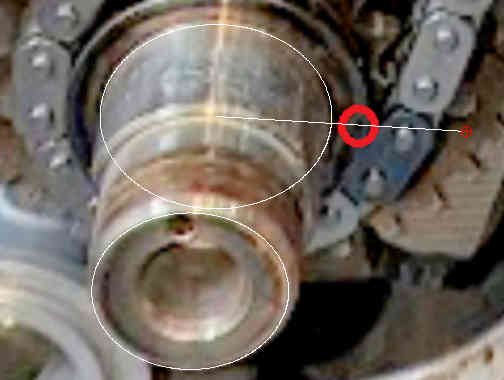

    Here's another pic of the engine timing.
    It should be between the link rivets, yes?

    I think I'm still with mr_guy_mann. Here's an attempt to deal with the perspective by fitting similar ellipses to the end of the crank and the ID of the sprocket, then adding a line through the dot from the center of the ellipse.
    Kind of a crude method, but I do think I'm more convinced that tooth ends up between the colored plate and the next one up, rather than between the two pins of the colored plate.

    Can you reassemble it all and get a good photo clearly showing the crank dot and tooth square in the middle of its colored link, with the top colored links squarely on the cam marks?
    What do you expect to see for the VVT-i gear "lined back up right"?
    It has a certain range of motion with respect to its camshaft, though it may also have a spring pin that should latch it at the most-retarded position (toothed part turned most clockwise) if you get it to that position.
    The exact phase of the VVT-i gear on the camshaft isn't really critical for installing the chain, because you're lining the colored chain link up with the mark on the toothed part.

    Then recheck alignment, get a good pic of the crank sprocket. Put the camera down low inline with the crankshaft.

    Is this better?
  14. ChapmanF
    28,654
    18,969
    Now that, I like.
    If I remember right, the 1NZ-FXE crank position sensor sticks in at about 8 o'clock in this picture. The signature gap in the position teeth is about 3 o'clock here, so if this is TDC then the signature gap in a scope trace should be around 120° ATDC. Anybody happen to know if that's right?

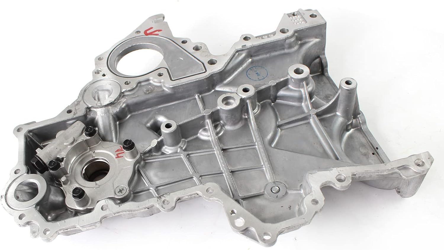

    Cleaning off the timing cover is a giant pain in the rear. No chemical seems to melt the RTV. I tried 5 different ones.
    Not to mention digging it out of all the little nooks and crannies.
    If I had the money I would have just spent $87 shipped on a new cover which comes with the pump.
    Which leads me to another irritation.
    You have to clean the oil pump completely out. Otherwise oil will drip down and potentially contaminate the RTV when sealing it.
    You can't take the screws out of the pump without messing them up, and no one sells just the screws.
    A new pump (with the screws) costs almost the same as a whole timing cover with the pump included (which makes no sense)
    So you have to run solvent through the holes to clean out as much oil and let the rest evaporate.
