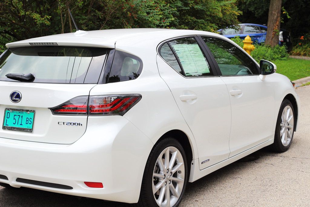

    Done deal, or it will be in a few minutes. Extended test drive went OK. Traction battery seems to provide just as much EV use as my Gen3 Prius did back in the day. I'm liking this car (hate the nav menus). This is appointed so much nicer than my level 5 trim ever was. That's my old Gen3 in the background -- which will morph into a new Prime about 130 hours from now.
    Next task is having a trailer hitch installed for the bike rack. Ideas on that would be welcome.
    Thanks, all, for your comments and suggestions!
    EDIT: WTH is the deal with that totally useless 3-inch long rear wiper?

    That is one sharp car. I think the only reason there is wiper on the back of there is to clear the back window when you first get in the car or sitting in traffic, ect. The back of mine doesn't seem to accumulate anything when driving at normal speeds. Not sure why its so small though. Maybe you could put a bigger one on if it's an issue. Again, really nice.

    I love white cars. Small white cars look gorgeous and this one is no exception. I see very few of those cars around here. How is the rear visibility?

    Not great. It is better after the rear 3 headrests were removed (temporarily without rear passengers). But, yeah, the blind spots suck, but not worse than those in the Gen3 Prius.
