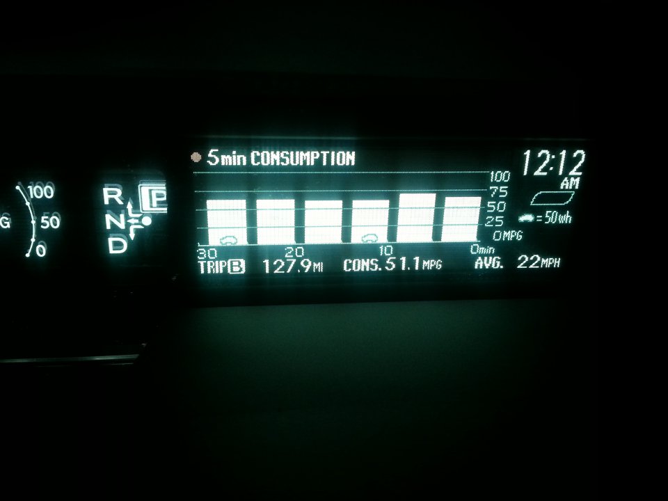

    Well I changed my driving on the way homeffrom work last night and got much better results. Driving using battery only to maintain a speed does hurt your mpg. A lot I guess lol. I posted a pic of my mpg graph. There was no pulse and glide or anything. I just keptthe rrims at a good speed. There are quite a few long large hills in my drive. I kept at 45mph. Still not near as good as I see others doing.

    It just takes practice to figure out what techniques work best for you in different situations. Even if you only add a couple glides at key points, it'll still help. Your tires are probably knocking a couple MPGs off, so you have to factor that in when comparing yourself to others.
