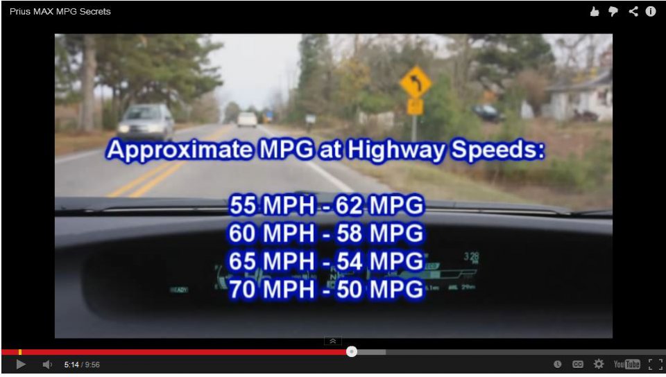

    This is from the technique video (see pinned thread):

  8. Mendel Leisk
    60,297
    41,483
    AC use plus speeds between 70-77 are going to lower your mpg. Look at the screen grab up the page.
