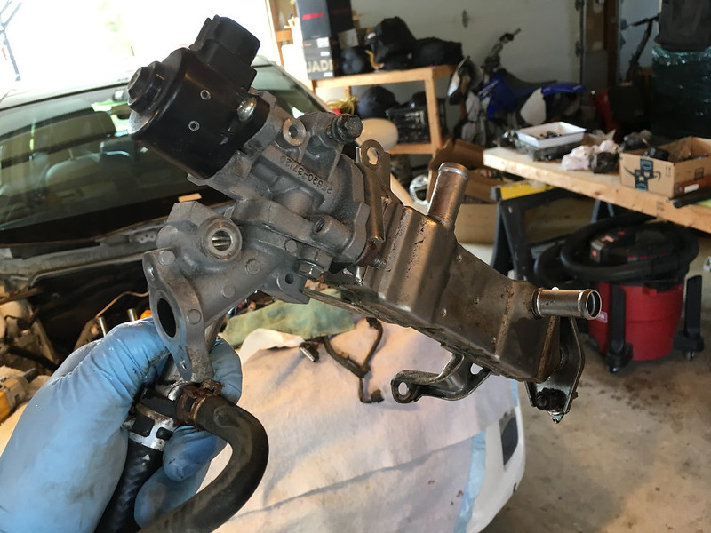

    What did you do with the EGR assembly (incl cooler)? Did you remove it from car? I was hoping to be able to leave the exhaust connected to it.

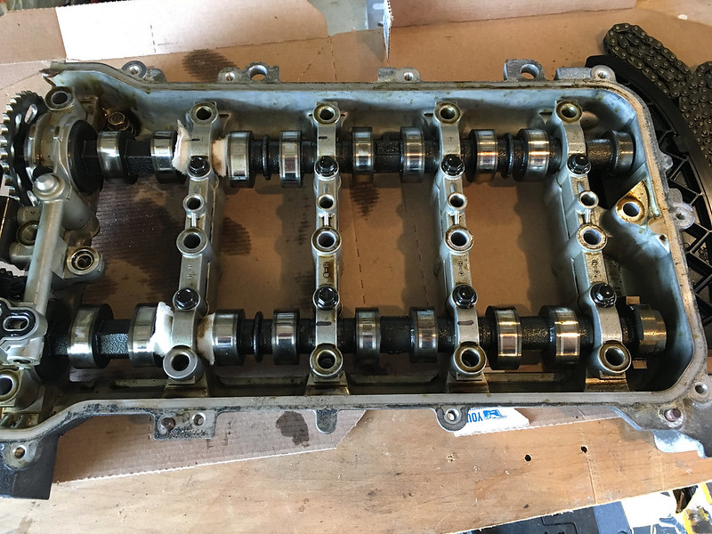

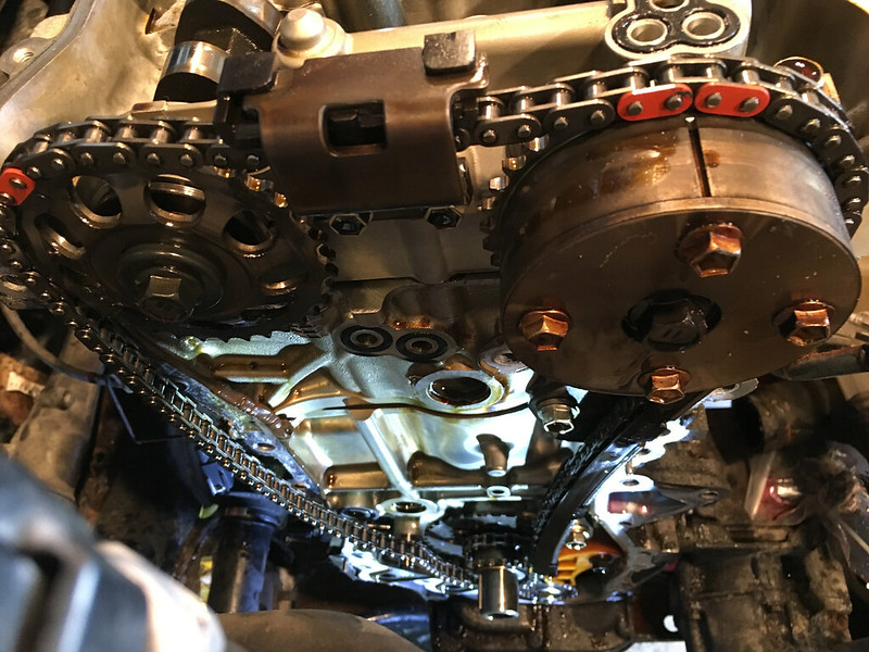

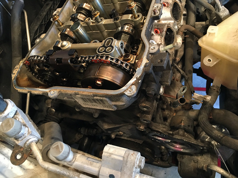

    Okay, a few pics...
    Here is how we start day two.
    Cams lined up and locked as shown in the amazingly helpful video

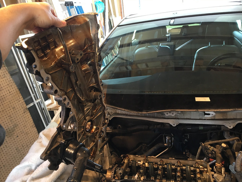

    Timing cover comes out. Not the easiest thing in the world, but not too bad.
    Timing chain
    Cam holder thingy out ...

    CA
    Hmm, you are not quite at TDC. If the crankshaft pulley is lined up with the “0” mark on the timing cover, the orange link on the intake cam gear should be closer to 1 or 2 o’clock and the exhaust cam gear should be at 12 o’clock. Not a big deal right now, but when you go to reassemble, having #1 at TDC is ideal.

    I didn’t notice that until you brought it up, but true. When I was assembling mine, I used the wrench flats to turn the cams and hold them while hanging the chain.

    Aren't you planning to clean out the whole EGR system including the cooler (and install an oil catch can) while you have everything apart?

    The cams are locked as in the video and cannot turn, and the crank is not moving. As long as all three shafts stay at the same positions and all three painted links on the timing chain match their respective marks as they did when I took it off, how can anything be out of alignment?

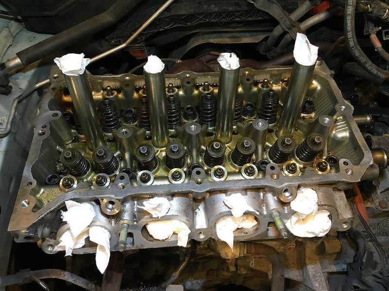

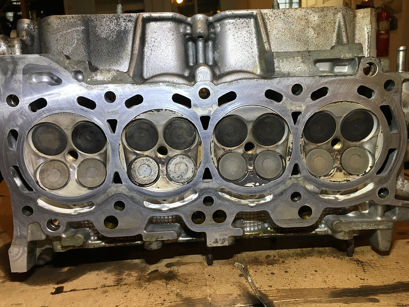

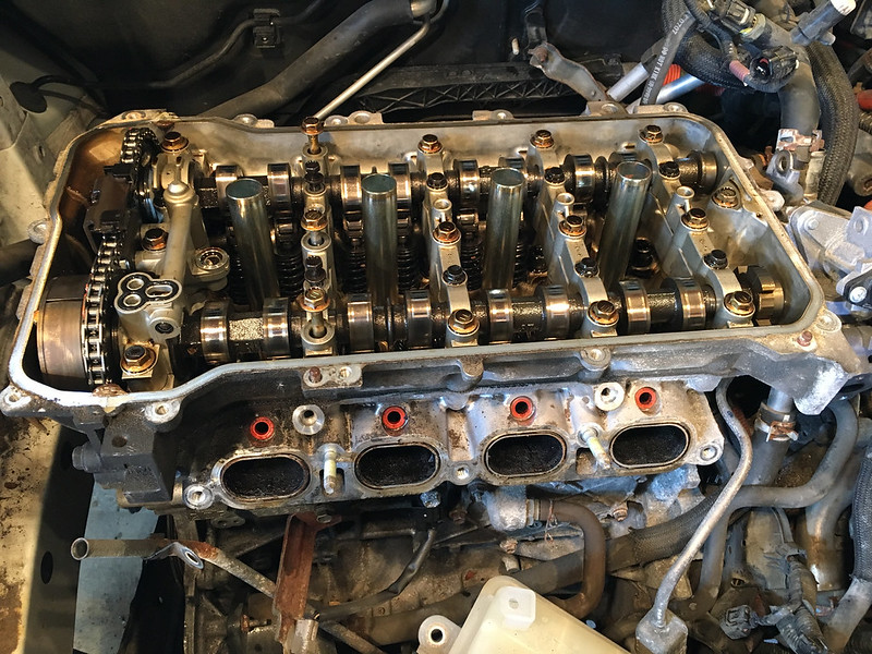

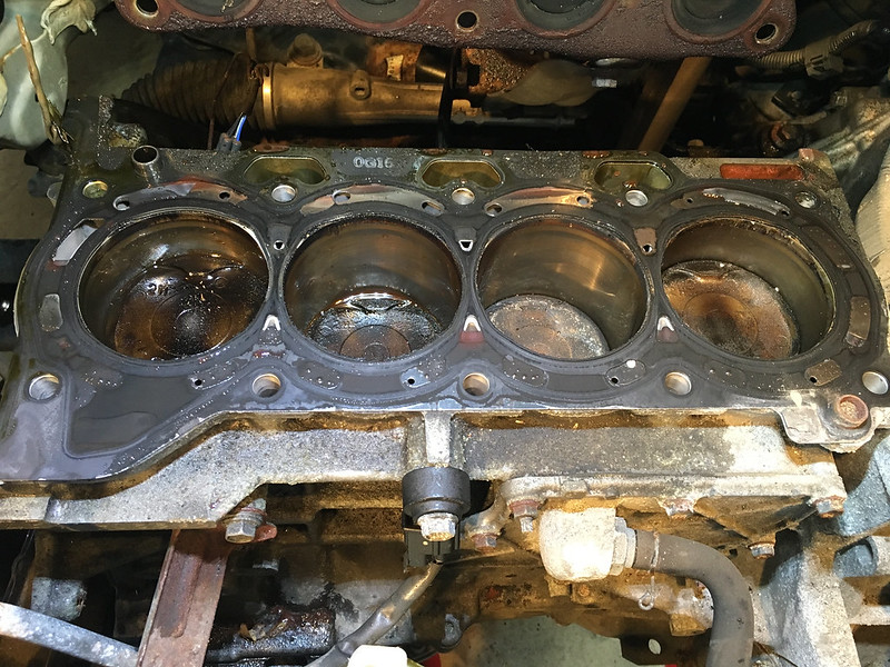

    More pics.
    The old... Some coolant still remains in cyl 2. (1 & 2 were missfiring primarily)
    Head after a little light cleaning
    End of Day 2. Head reinstalled with new gasket.

    I plan to take it all apart and clean as in the videos. Though EGR pipe doesn't look so bad honestly for so many miles.

    Make sure to get the cooler though;).
    Having it out makes the access extremely easy:).

    Given the close tolerance for piston to valve clearance the only approved location for timing chain installation is with number one at TDC. However, if you are 100% sure none of the shafts have moved at all, after installation of the chain, timing cover and tensioner, it is recommended to rotate the crank by hand at least two full revolutions to insure no interference. I rotated mine until the twin links lined back up on the intake, the single link on the exhaust, and the other link on the crank. Two crank teeth off is all it takes for interference.
