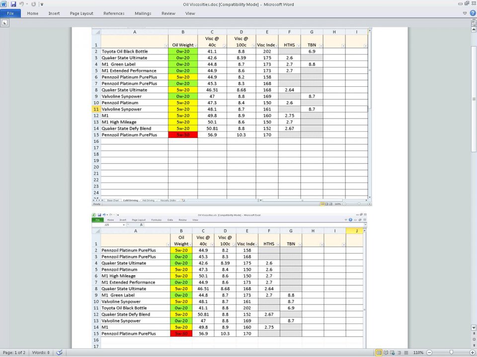

    Oil Viscosities.JPG Recently we had a civil, if short of fact, discussion on the value of viscosity. The question was posited as to the true value of 0w-20 and 5w-20 in our C's. I've always been one to ask Why?, and was taught many years ago to question those that say "We always did it that way." or "Because the book says so." When working on an aircraft, things are done by the book. The book has the experience of thousands of engineers and maintenance gods. Routing messages over a military comm line, you take your addresses out of a book that gets updated every night at 0001hrs. You never route from memory - you always get the address out of the book. But what about maintenance from the Toyota book? Books from different countries and regions differ in their recommendations for the same physical vehicle. Other things will obviously work and not damage the vehicle. But you don't know anything about oil, oil types, oil weights, or oil viscosity? What to do?
    What to do, indeed. Where in that maintenance manual must you do precisely what it says and where is there a "suggestion" or "recommendation?" Sometimes it's spelled out or is obvious. A sparkplug size would be pretty much a specific thing. Fuel octane is not written in stone, and you CAN use any of several different octanes. Tire size is variable, as is inflation pressure. But, obviously, there is a range of sizes that work and some that don't. You don't HAVE to wash, wax, and clean inside and outside of your vehicle, but if you want it to last longer and look better it would be a good idea.
    How much you follow the book would be a function of how much you know, how much experience you've had stretching the recommendations, and sometimes just plain old observation.
    Which brings me to where I was headed...Oil, and oil viscosity as it relates to our C's. I have attached a chart of various oils and their viscosities. Our prior conversation touched on the maintenance recommendation (more like the insistance, with stink-eye) of using 0w-20 in the C. I raised the idea that this particular item may be flexible. That idea was not universally accepted.
    Taking a quick look at the charts in the attached file, you'll see two tabs. One tab has the oil brands and weights listed in order of cooler viscosities, the other has them listed in order of operating temp viscosities. The 0w-20's are highlighted in green, the 5w-20's in yellow, and a single 5w-30 added in red for a reference.
    Checking the cool oil order of viscosity, you can see which might be most mpg-efficient if you drive in the city or your engine most often sees cooler temps. Looking at the hot driving tab you can see which oils might be most mpg-efficient if you drive mostly on the highway or your engine is always warmed up and ready to go.
    These are all numbers taken from the manufacturer websites this week, so they are recent numbers.
    But what I find most intriguing and thought provoking, as it relates to the maintenance manual oil viscosity heavy-handedness, is that the viscosities of the 0w and 5w 20w oils OVERLAP. This is most evident in the hot driving tab. Imagine the heads exploding seeing an actual 5w-20 has the lowest hot viscosity! Oh, and look at the alternating viscosities after that one.
    Read this part carefully - I am not telling you how to maintain your car. I am not telling you what to do. If you want to go by the book, I DON"T CARE. Go for it. But if all you are going to do is blindly repeat the maintenance manual and give no further reasoning...go back into your hole. I am not interested in Absolute Maximum Effectiveness or MPG. That would be an opinion or a statement impossible to prove due to the myriad control points. Make a statement, defend your statement.
    Now...discussion?

    Good data. I recall prior data the Toyota synthetic looked good as well.
    What you might want to look for is A5/B5 ACEA rating on the bottles, which I believe is the best rating with respect to longer drain intervals. However, the lower viscosity 0-20 and possibly even 5W-20 for the most part do not seem to qualify for the A5/B5 in the USA last time I looked. I never had a chance to look at the Toyota synthetic bottle to see if they might have the A5/B5 on there.

    A quick check of some of the oils, but of the seven I've looked at not one of them is A5/B5 rated. The ones that were rated were A1/B1, and the others not ACEA rated at all. Yet, no complaints have been heard from 10k mile intervals for the M1 extended performance, or the M1 0w and 5w-20 M1 and M1 high mileage. I'll look into it more when I return from lunch.
    "A5 / B5 - For use in high performance car and light commercial petrol and diesel engines designed for low viscosity oils where extended oil change intervals are specified by the vehicle manufacturer."

    Dr Haas' oil info is truely enlightening, but geared towards those who operate their cars towards the edge of the envelope (sanity?) At that point there is little slack to be had, and being able to crunch the numbers is mandatory if you want to keep your $750k grocery getter. I wouldn't think that our C's engine is very stressed or abused, even when floored over and over and over and over. The redline shows as mid-4grands, and that ain't nothing'. The only REAL stress it would see is starting it up in sub-zero weather and mashing the gas to the interstate and repeating daily. Viscosity numbers at that place would be very much a thing to know and watch.
    But anywhere else, is it really all that big of a deal? Really? We've seen or heard of cars that are severely abused and neglected going over 200k miles, or maybe Uncle Joe's car had cheap oil replaced at extended intervals by more cheap oil, yet lasted long and left the driveway for the next owner under it's own power.
    How much of an issue is it to put in a heavier oil over the winter? Wear at startup? How much is too much, can you quantify it (other than maybe UOAs) and where do your habits bring down the pointer?
