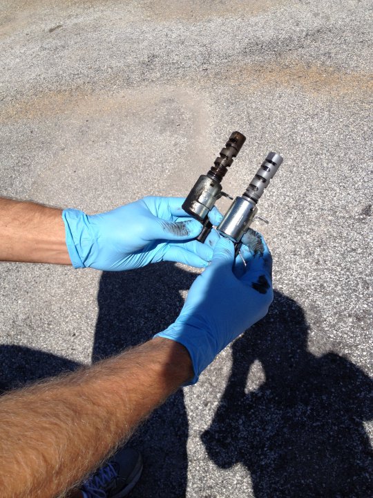

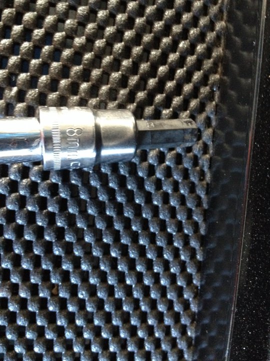

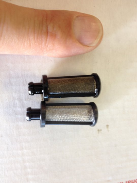

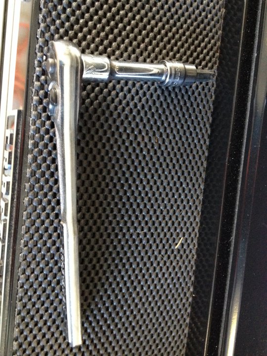

    Thanks for your help Ed and Patrick.
    Here are some pictures that may help any one else who wishes to change this filter. I also changed the valve. This filter is much smaller than I was picturing in my mind so I can see why a thicker oil or sludge would cause a problem.

    That filter looks like pretty coarse screen, like screen door screen. I don't think I would worry too much about dirty oil causing restrictions. Unless, there are chunks ...

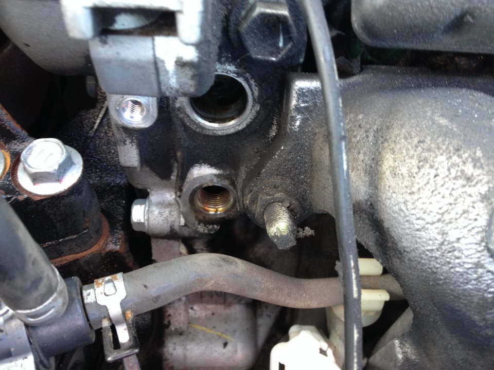

    Very good pic #2019 of the area in question. Finally a pic of the exact area. Thanks. That solenoid looks very dirty or burnt oilish. Car must have lived on dyno. I would take the v cover off and look at the cams too.
    I would have flushed that area off first with carb cleaner before taking the filter & sol out. Clean that whole area up first. So dirt doesn't get in the holes. That and I like the smell of it.:confused:

    Yes that looks right it's a female hex head bolt. Intake #1. The big round thing next to it is the VVT valve.
    Make sure you use a quality hex socket not a harbor freight pos as that hex bolt was really really socked down. Standard lefty loosely. There's a filter screen in there and a little rubber gasket if I recall.
