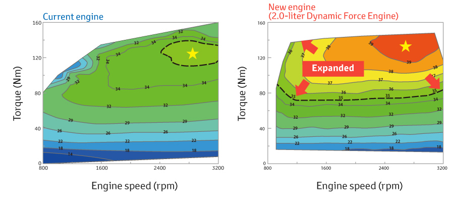

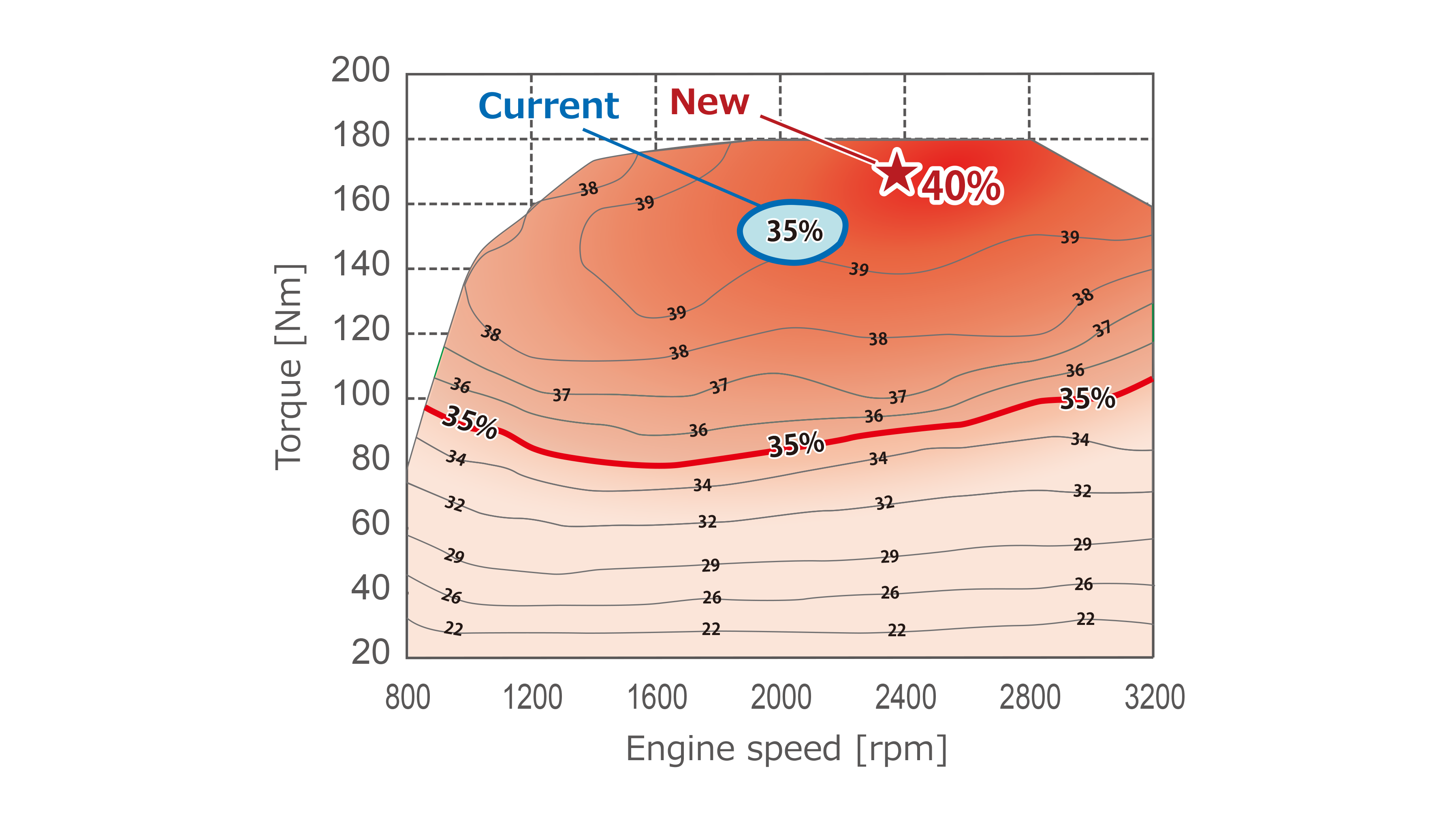

    Note that those efficiency numbers are peak efficiency, they don't tell the full story.
    This is what we've got for BSFC charts from Toyota:
    2.0:
    2.5:

    What amazes me, actually, is how closely these engines track on efficiency down the BSFC chart - the lean burn capability of diesels tends to really help them at low loads, but the part-time Atkinsonization seems to really help the Dynamic Force engines keep up.

    I like graphs showing 3rd dimension as color :)

    The only part missing is the operating line:
    Source: Brake Specific Fuel Consumption (BSFC) Maps - EcoModder
    What the cheat-diesel advocates could never get over was how the hybrid transmission turned off the Prius engine in inefficient power bands. Zero fuel burned has always been lower than diesel running at partial or low power. The only way the diesel competed was to keep the power settings high like the "Portland-to-Portland" stunt. Even then, they didn't factor in the higher energy content of diesel.
    Great charts, from SAE papers?

    The first two charts are from Toyota's marketing press packages on the 2.0 M20A-FKS and 2.5 A25A-FKS respectively.
    The third chart is from Ecomodder, presumably from some technical document that VW released, but I don't know what - maybe it was an SAE paper.
    The operating line isn't relevant in those, because they're the non-hybrid options - @austingreen was talking about the Camry and 2019 Corolla, presumably the non-hybrids. Toyota didn't release BSFC information on the FXS versions of those engines, outside of the peak 41% efficiency. That's also why I addressed the lighter load regimes.
