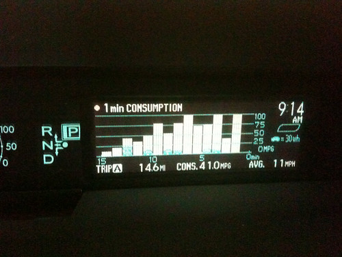

    In my (limited) experimentation I noticed the Prius keeps the ICE spinning more often when in power mode, even when the engine is fully warmed up. I was driving around in the the mountains with the coolants temps around 185F and it still seemed the ICE was running more often. (When in motion.) Everything is still shut down when stopped, though.
    I tried using power mode during warm up on the way to work today. (Only about a 13-14 minute commute all on surface streets with lots of stop and go.) Not sure it helped. When I arrived at the office, coolant temp was only 164F.
    I'll try it on the way home today. (Which seems to yield slightly better mileage as it's slightly downhill.)
    Anyone have similar experience with power mode and ICE spinning? It could be a good qood way to speed up warmup if it's valid. Overall warm up really kills my commute mileage since my average speed to work is only about 13mph which doesn't give the engine any time to warm up and get to full hybrid operation.
