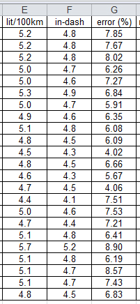

    With our 3rd gen hatchback, Toyota has managed amazingly consistently inaccurate readings:
    My take: they've pushed it just as far as they can, without it seeming ludicrous.

    Umm, no.
    The minor variations introduced by variations in fillup, tire condition, and on and on: cancel out, with as few as two fill ups.
    If you fill up 'till the pump shuts off automatically, record your odo reading, do the math, and repeat: 2 or 3 fillups down the road you'll have a near deadly accurate estimate of your mpg.
