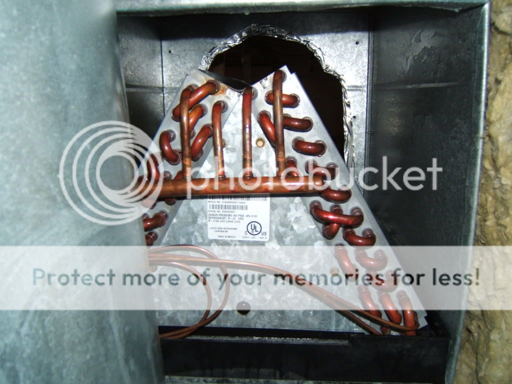

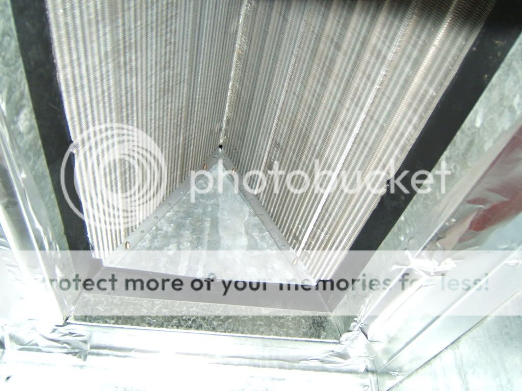

    We popped the unit open and the first thing he noticed was that the evaporator coil was an aftermarket 4 ton (Summit) instead of a matching Carrier. The problem with that was that to install it they had to blank off about three inches on either side of the Carrier housing for this narrower A-frame. In looking at it and the furnace baffles his comment was, "builder standard"--as in cheap junk. He thinks that the narrow channel is the main flow bottleneck. He said that the Summit coil was sized as a retrofit into smaller, older low efficiency furnace set ups and although officially rated as 4 ton, shouldn't have been mated with the condenser and air handler in the system. Basically, it is a mismatch meant for a much smaller airflow in an SEER 10 system.
    The fouling I expected to see wasn't there (and he had predicted that it wouldn't be matted because of what I had told him what I observed of flows.) We did clean it off anyway, but he thinks the problem is in the air flow restriction. Keep in mind that since summer I've tightened/sealed the system and cabinet a lot, so more flow will actually move past the coil than before--I expect that alone to make a measurable difference this year (it already has this winter.)
    He figures the low cost short term option is to replace the evaporator coil with a properly sized one (and install a TXV). He says this is really only viable for 2009, because of the end of new R-22 equipment manufacture on Jan. 1, 2010. That's not necessarily what he recommends, just a "make the old system work as best it can" option.
    He also noticed the catch basin was plastic/resin and showed some signs of warping from overheat, and tried not to touch it as he suspected it would crack if he did. (There was also about 1/8-1/4" wide gap on our end, a bypass stream around the coils. By my estimate that works out to about 3% of the total flow area, and at a fraction of the DP it might be 10% of the capacity of the coil, lovely.)
    The blower is a three speed 1 hp. The old board is configured for high for the fan setting and the AC, but for medium (1/2 hp) for the furnace. I'm going to measure the blower draw during the next cold spell to verify. It's too bad that I can't set the fan to 1/2 hp (medium) during the summer so that I could get the circulation I need without running the AC as much. Afterall, with constant fan operation I don't need high velocity across the coil. The problem as he explained it is that if I tried that the old board would use the lower fan setting instead of the higher AC setting when the AC is on.
    We also leveled the compressor and he cleaned the condenser coils. They looked pretty good from the outside and inside on a quick visual, but the space between the two rows of coils was clogged so that water couldn't get through. Eventually, he managed to get some water flow all the way around. He added that when he tore out old two-rows for salvage that he had just cleaned up, when he cut them open they were still full of junk stuck between the rows. His observation was that they only performed well the first few years. So while I have flow restriction in the air handler, I might also have been losing condensing capacity as well (and still will be, but to a lesser degree.) I guess I'll get a better idea this summer.
    He's going to make a proposal for options on a complete matched system with variable speed. For this house, efficient blower operation can save a bundle while addressing stratification. He agreed with my plan for adding a return from the sub basement if I can figure out how to route it. He knows I'm in no hurry, but want some options for when this system has any serious failure, the savings/incentives look right, or when I get sick of trying to tweak the turkey.

    I know you wouldn't joke about something like that. Oh boy ... what a mess ....
    Yes, very obvious. It's a wonder this crap even works at all
    I agree. But first see how it works with the ductwork sealed up. Just to buy you some time ...
    My drain pan is also resin, and after 5 years is in good shape.
    You'll notice I keep my e-coil squeaky clean
    At least with my Bryant, without the Evolution control network, you can fiddle with DIP switches to fine tune the blower speeds on heat and cool.
    Those two-row things seemed a good idea at the time, but in hindsight somebody should have figured out they would plug up. They're not impossible to clean, but just about so ...
